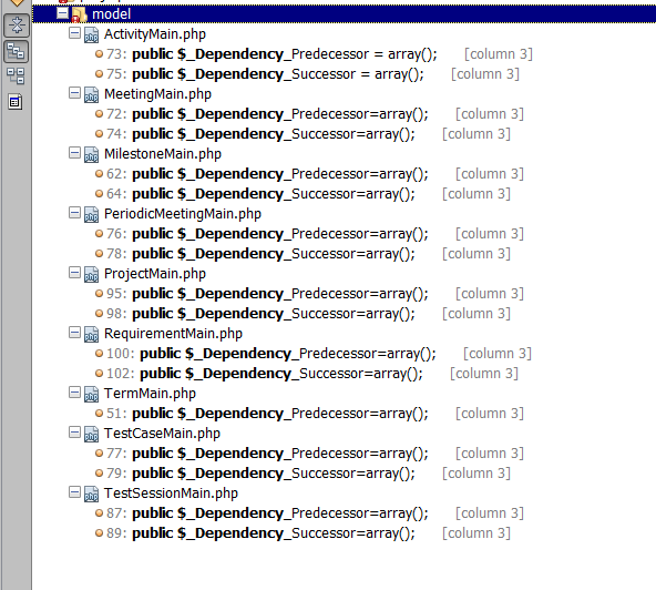

21 Mar 2019 11:24 #9 by Envergus
Check your dependency table.
those you cited (Activity, ...) have dependencies (tickets for instance do not):
Good luck
The following user(s) said Thank You: LaurentCap
21 Mar 2019 15:29 - 21 Mar 2019 15:46 #10 by LaurentCap
Thanks Envergus for your help.
So I check my dependency table (677 records) :
I delete dependency from and to project
=> error is always there
I check that all the predecessorRefId and successorRefId are existing
=> all Id have record in the relevant table
I check If a successor is also a predecessor
=> all is clear
I don't know what to check further. Have an Idea ?
