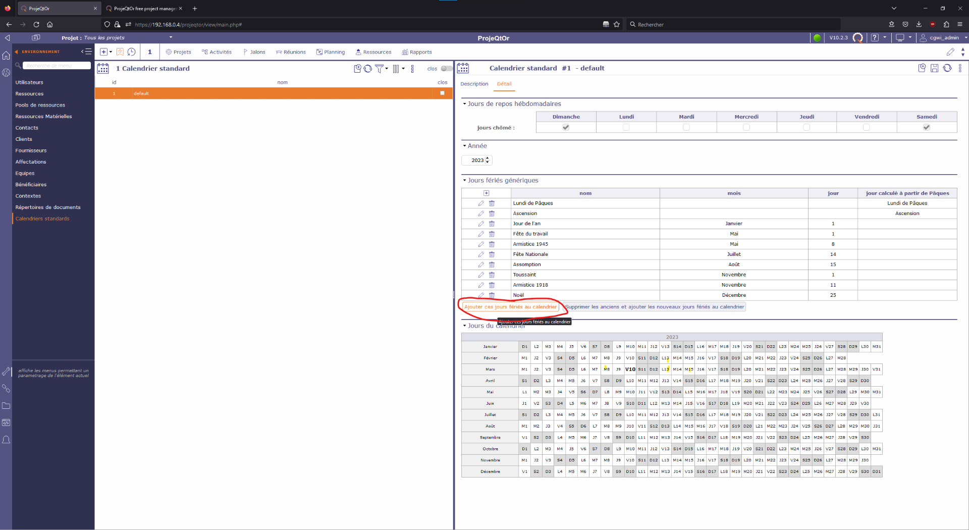

10 Mar 2023 09:27 #5 by kbcgwi
I set the script log level because with the other levels, I don't see anything in the log file.
Attached is a screenshot of the calendar view, but I don't think that you will see something wrong (I click on "Add these public holidays to calendar", but only the weekend days are marked as days off).
Also, when I click on a specific day on the calendar on the bottom, nothing happen too, the day is not marked as a day off.
I try to create a new standard calendar, but the result is the same.
10 Mar 2023 16:30 #6 by babynus
Strange, no issue , no erreur.
Do you connect as admin to manage the calendar ?
