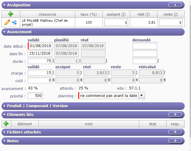

Something bad happens to the first task "Analyse du besoin" as you can see in the next capture :
After I click on "calculation", planned date (start/ end) and real date (start / end) are wrong.
Real work started the 7 of august but It continues after this date, nevertheless real end date is null. Why ?
One day is planned (07/08/2018) although left work is 5 days. Why ?

In my example, task "Analyse du besoin" is "planned" between 01/08/2018 and 15/11/2018.
Mathieu started the 07/08/2018 and continued until 26/10/18. 3,81 days is done until now but he has to work 5 days more (left work) to finish the task.
Mathieu is available 20% for the project (1 day by week) and 100% by day for this task.
If I launch calculation since 01/11/2018, I imagined that projeqtor divide 5 days left in 5 weeks, so I expected a end of task planned at 29/11/2018.
As you can see on picture, planned end is equal with planned start (07/08/2018) : Why ?.

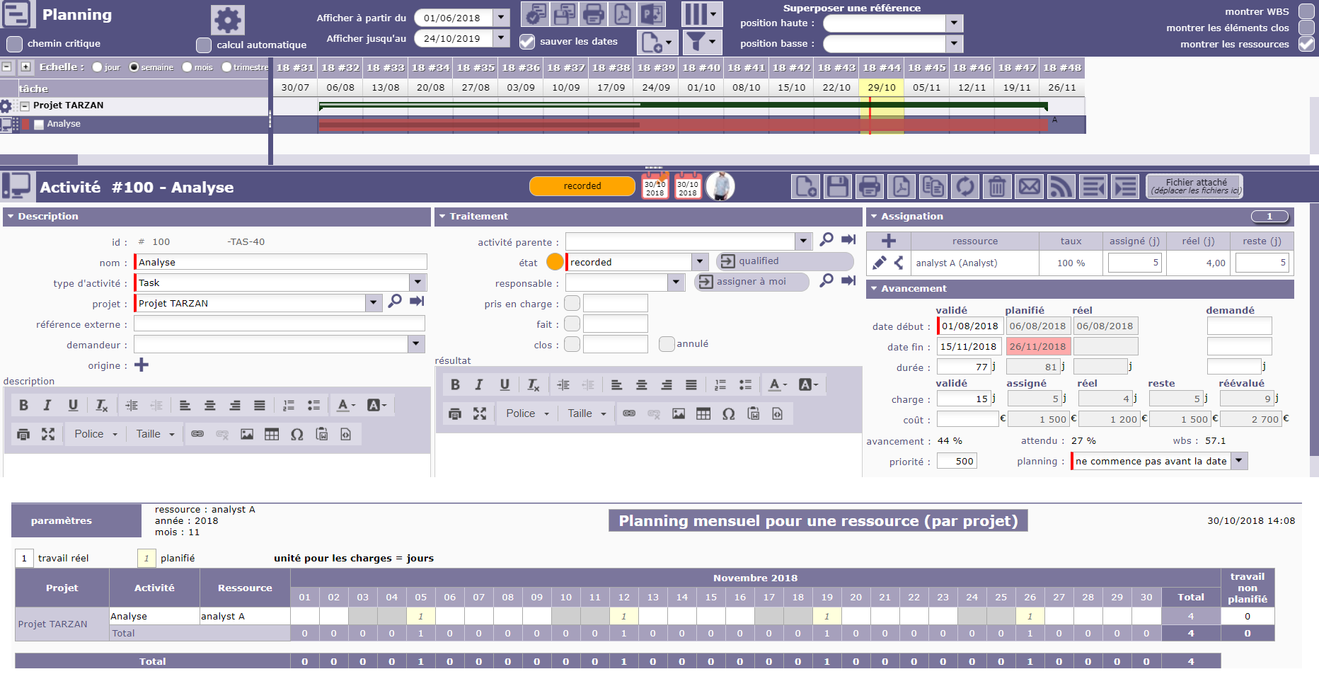

I tried to reproduce this issue on your demo database :
I created a project name "Projet TARZAN", I affected Analyst A, available 20% on the project.
I created a task "Analyse". I assigned Analyst A available 100%
On TimeSheet screen, Analyst A work 6, 7 and 8 august and then the 15 october.
5 days left work then I lauch calculation :
As you can see, end planned date is correct and Analyst A is planned 1 day by week as I expected
