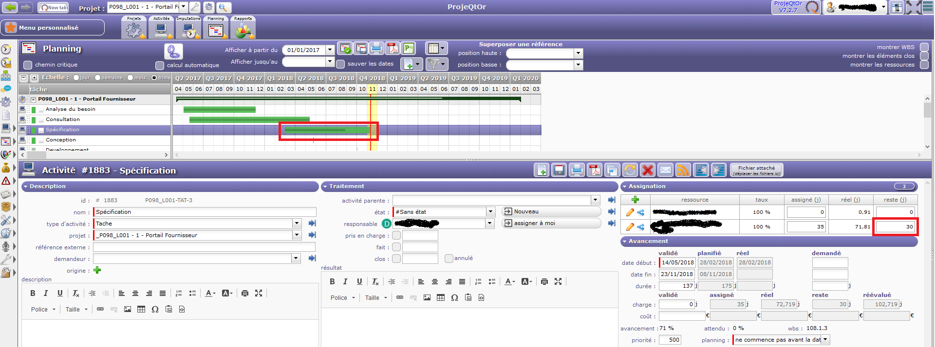

Hi
I tried with version 7.2.7 but it's the same thing
If left work is not set to 0 then projeqtor is unable to calculate planning.
Look at this planning : activity "specification" is well displayed on Gantt but left work is set with 0.

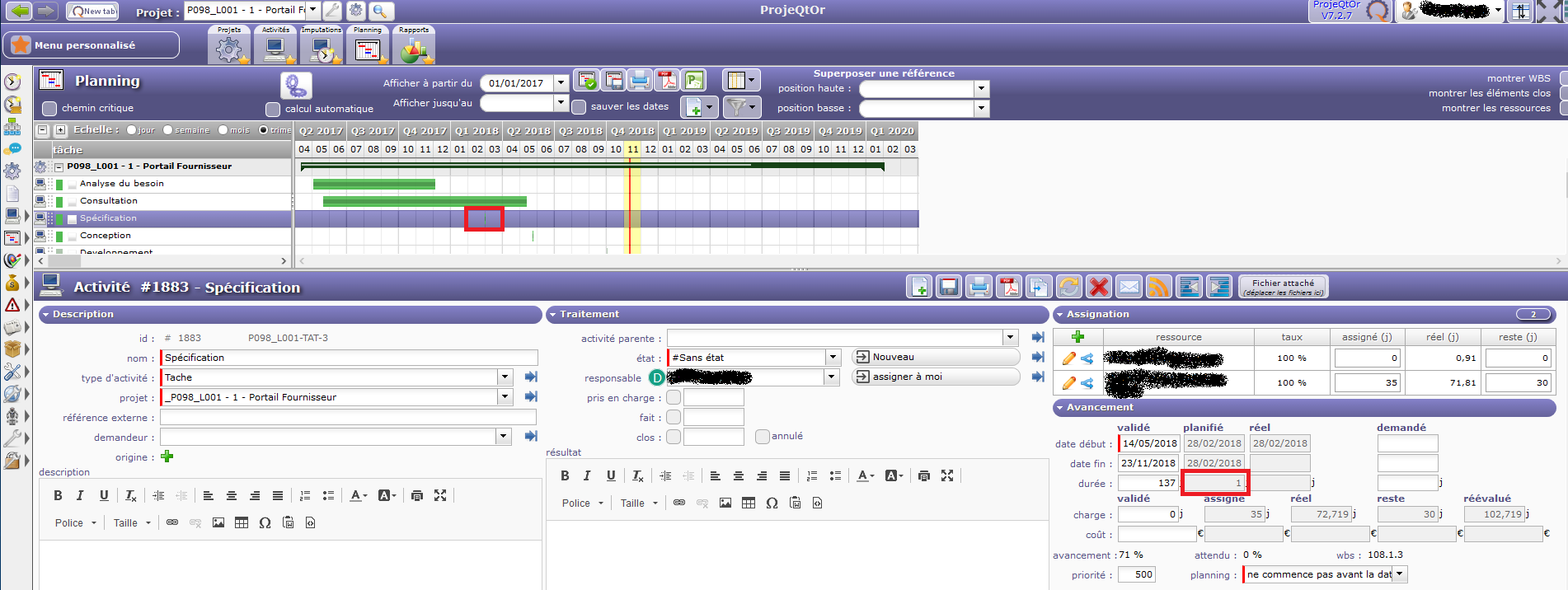

Now I decide to increase left work to 30 and I save. As you can see, activity progress changes on Gantt and it's OK.

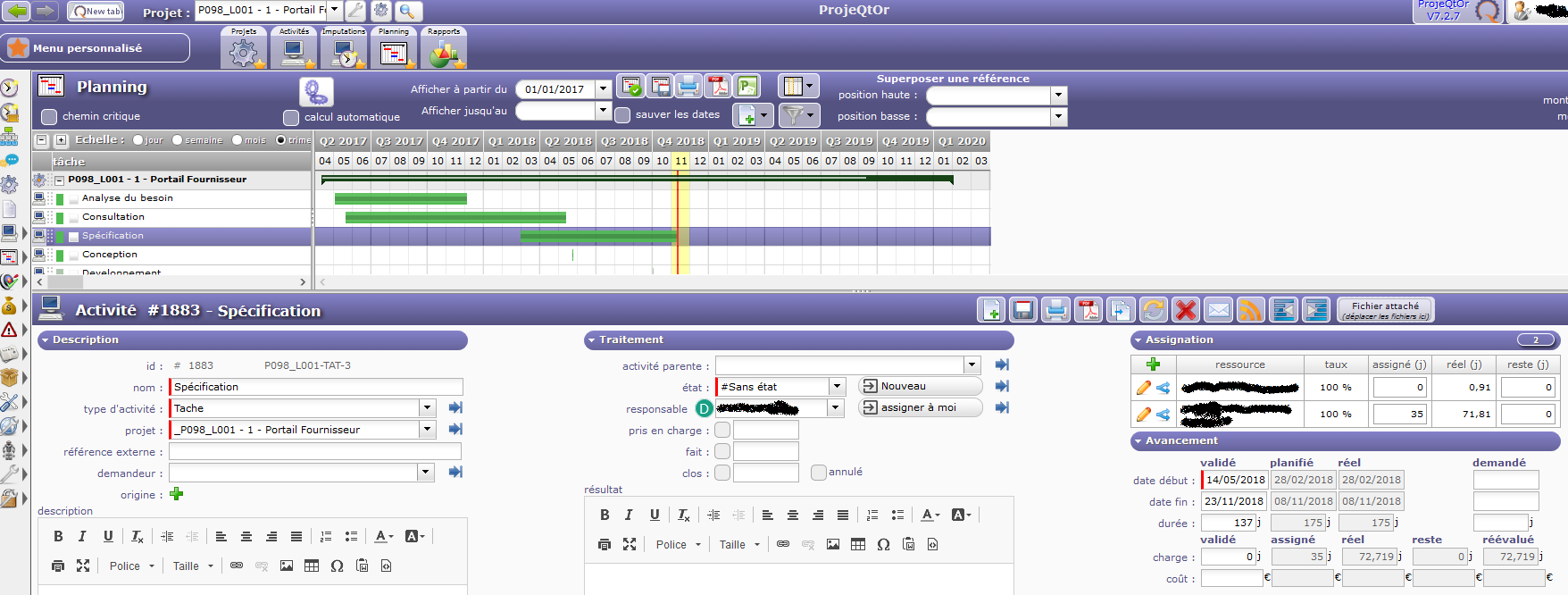

Now I launch planning calculation and activity specification "disappear" (in fact, just 1 day is displayed on gantt and planned duration is only 1 day)
Explain me if it's not an issue ...

Replied by babynus on topic Planning calculation
What can explain this is capacity of resource : capacity is Full Time Equivalent. Thids means that normal resources have capacity of 1 (hability to work 1 day poer day).
Possibly you changed capacity to more thant 30.
For instance if you changed capacity to 100, it means resource can work 100 days per day, so can finish 30 day task in 1 day.
