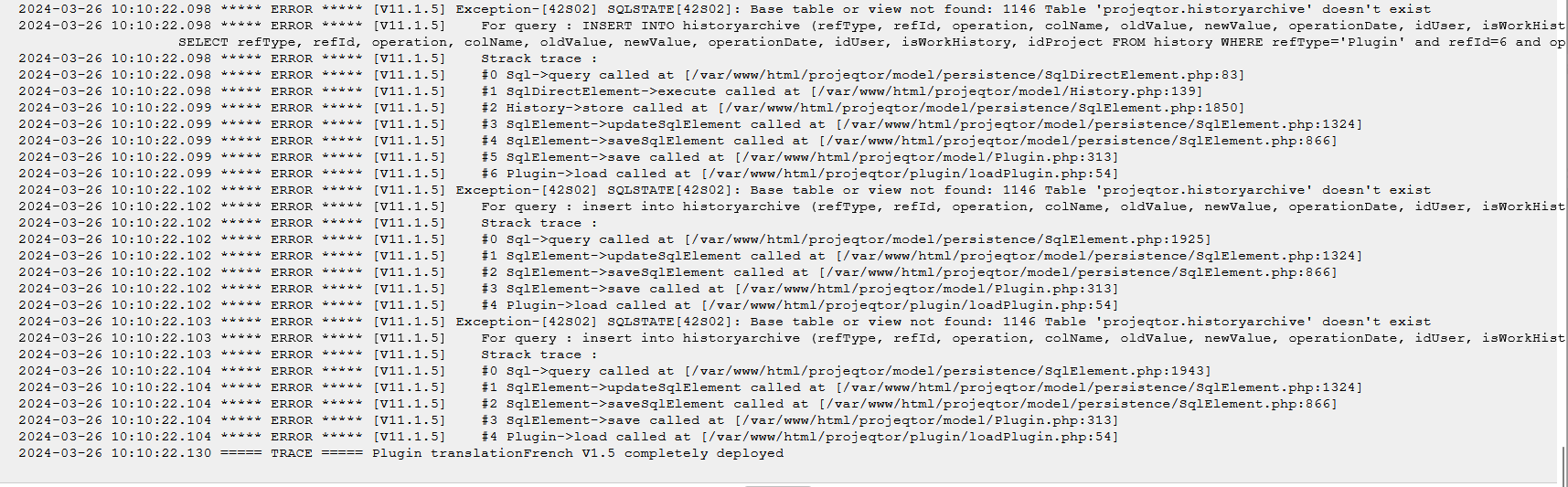

First, on the Projeqtorcab I got this error message at some point in the log
Is it asking me to recreate historyarchive and each column in the table ?

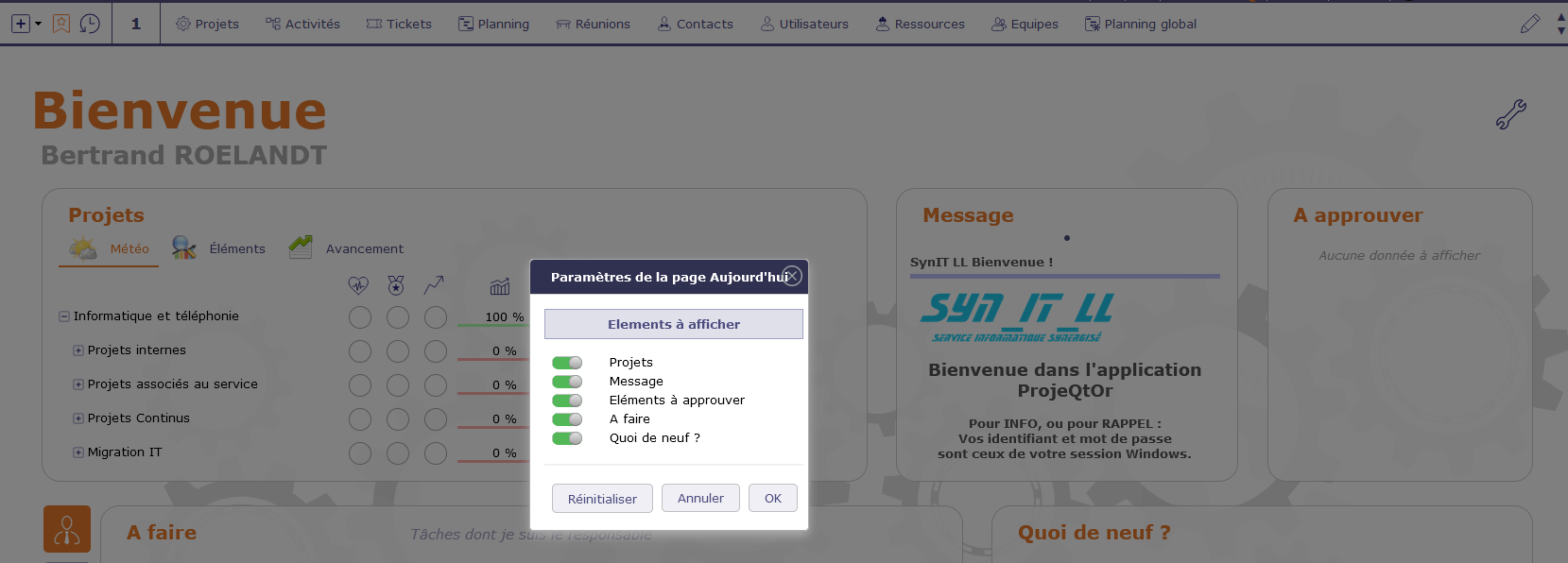

First Image is the Main Projeqtor (the already updated one)

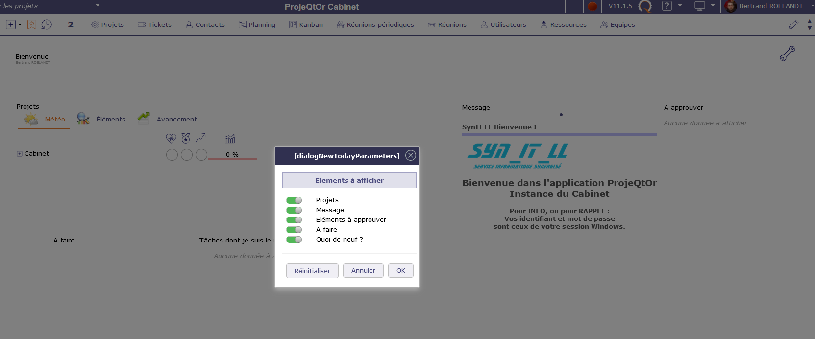

The second one is the Newly updated Cabinet test (still on Debian 9)

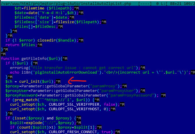

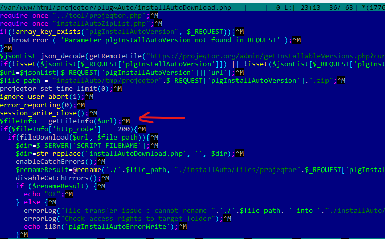

When we click on the new updates in the plugin AutoInstall, it doesn't do anything and we get this error
I checked the same php files on the debian 9 Cabinet and didn't find anything different but maybe I missed something (we don't touch the php files in Projeqtor unless its something you told us to change)

19 Apr 2024 15:17 #8 by babynus
historyarchive must exist.
So you have to create it (even if empty)
25 Apr 2024 14:17 - 25 Apr 2024 14:56 #9 by Cpt_Jabberwock
Thank you,
From my last post, the 4 problems
1 & 3 were linked, for some reasons
I haven't had this error log since recreating the Historyarchive table
and the screen got its background and the options got their proper name header after the table got added back to mysql
2: No Idea what that thing is still
4: Problem on updates on the Debian 12
it was the Curl extention of PHP that isn't installed by default on new server
thus making Autoinstall work again on the new Debian 12 (since we copied only Projeqtor, we had forgotten that Curl was an addon not installed by default)

06 May 2024 13:13 - 06 May 2024 13:20 #12 by Cpt_Jabberwock
hello again, hopefully this will be the last problem on this topic
We finally migrated to Debian 12.5 and Projeqtor 11.1.5 from the old Debian 9 Projeqtor 9.5.5 for our last Instance
Everything worked in our tests, but on the final stratch, I get these problems
1. I have the same problem as before on some pages (ie: Today page)
The dialogue box doesn't have proper title in french and the page itself is missing formatting
