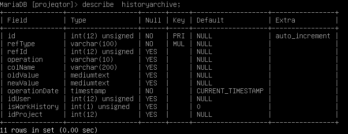

first, the dump of the mysql db has a problem when touching "historyarchive" table (biggest table of the entire projeqtor db)
it can read about 75% of the table but crashes and loses connection when nearing the end of this specific table (historyarchive) which seems to be the history of every action done followed by "save" in projeqtor from what little I understood of each entries
mysqldump -u root -p --ignore-table=projeqtor.historyarchive projeqtor > projeqtor20240209.sql
worked, bu not
mysqldump -u root -p projeqtor > projeqtor20240209.sql
select * from historyarchive;
makes the command crash
select * from historyarchive limit 100000;
works, bigger like 250 000  or such, will crash

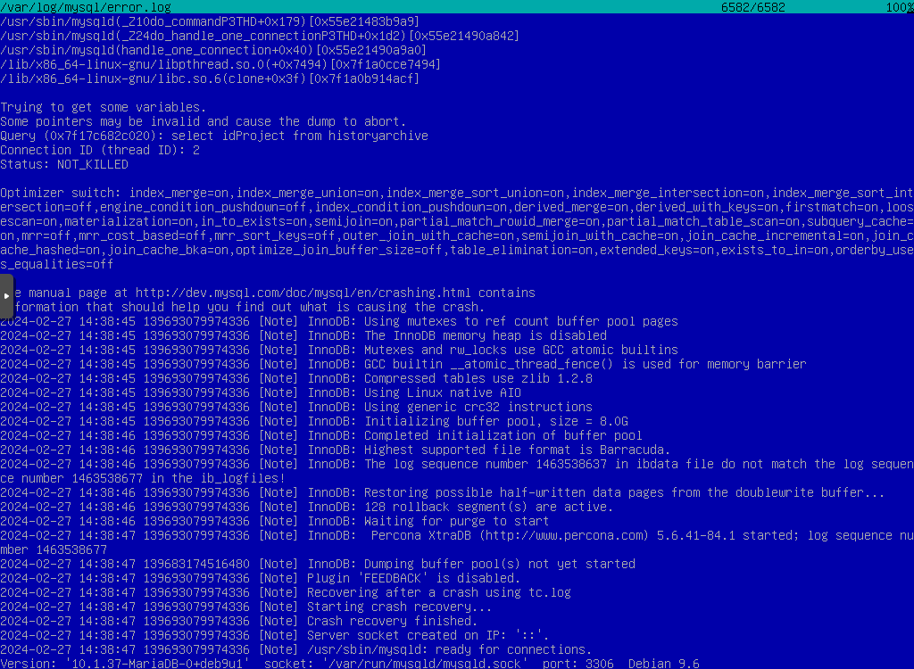

First attachment is what happens in projeqtor (log) when we did a dump and the dump didn't work
File Attachment:
File Name: projeqtor_...0227.log
File Size:4 KB
in mysql we had those
This is the log of mysql
and my colleague did those
* in the file /etc/mysql/mariadb.conf.d/50-custom-mariadb.cnf he added
* and also innodb_force_recovery = 4
* Deleted the files ib_logfile0 et ib_logfile1 et ibdata (/var/lib/mysql).
* launched the command  mysqlcheck -u root -p projeqtor
all without success
Doing a dump of the db without Historyarchive and doing a dump for it separately worked (all at once doesn't work)

How would we go about purging the Historyarchive table in Mysql ?
There is not need, and no real need the retreive it : historyarchive stores history of changes that are older than 1 year on concerning closed items.
Take care that installing ProjeQtOr 11.1.3 then installing DB from old 9.5.5 without purging the DB will leave some tables created between 9.5.5 and 11.1.3 (the dump does not purge all tables, it erases and recreates tables existing in the dump).
Side effect is that you'll get errors when migrating to V11.1.3 because of already existing tables. This is not a major issue (tables are correct) but you must be aware of that.
