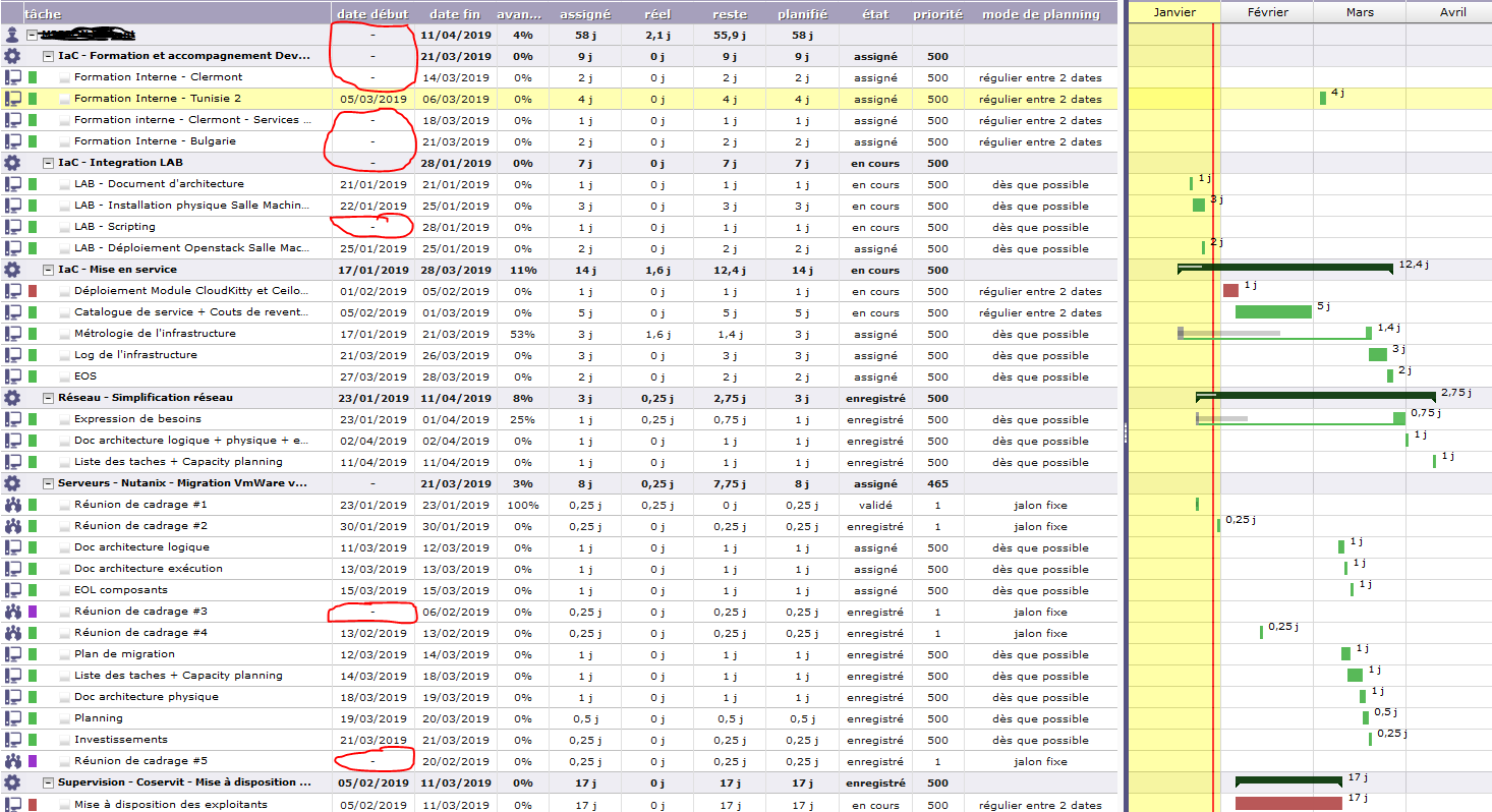

28 Jan 2019 14:25 - 28 Jan 2019 14:38 #14 by timshel
Capacity of the ressource : 1 ETP
Project assignment : 100%
Task assignment : 1 day
As you can see on the picture attached, some tasks don't have start date.
Last edit: 28 Jan 2019 14:38 by timshel.

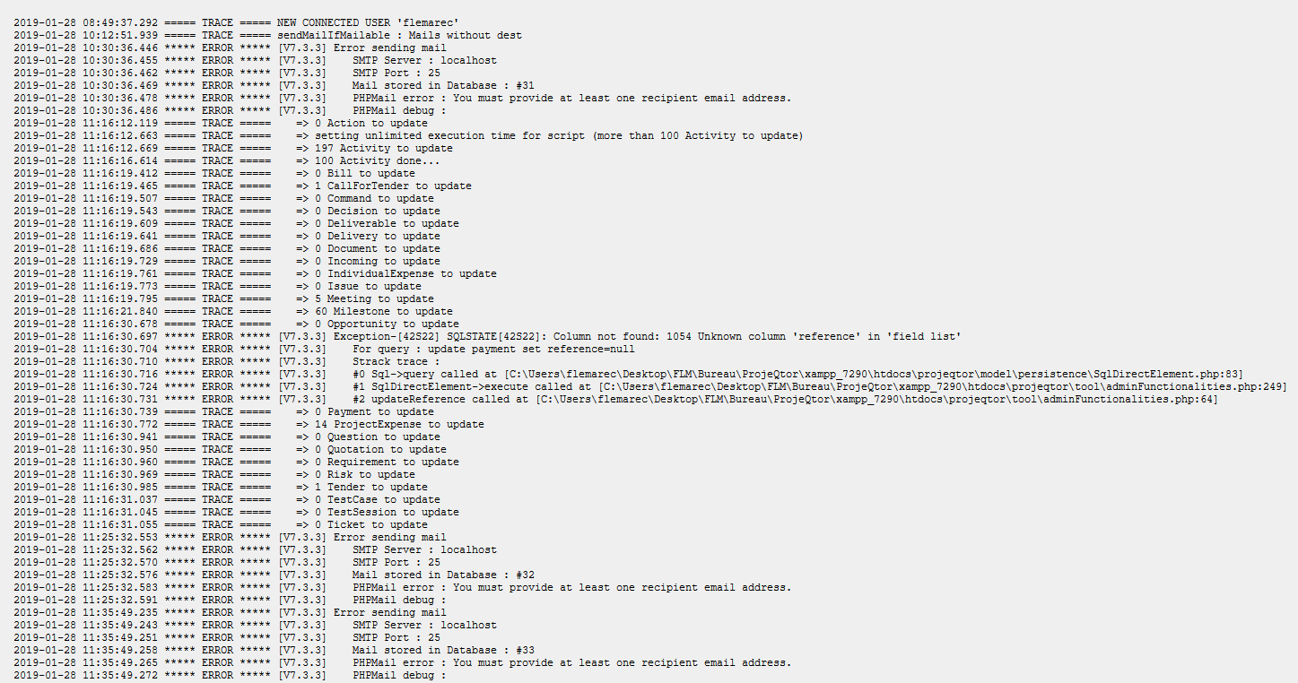

Also check for errors in log file.
28 Jan 2019 14:40 - 28 Jan 2019 14:45 #16 by timshel
I'm administrator and the specific ressource is "Team member"
Log file in attached file
Last edit: 28 Jan 2019 14:45 by timshel.
28 Jan 2019 14:54 #17 by babynus
There is nothing on log file that could explain the issue.
Only error logged is fixed on V7.3.4 and has no effect on planning.
