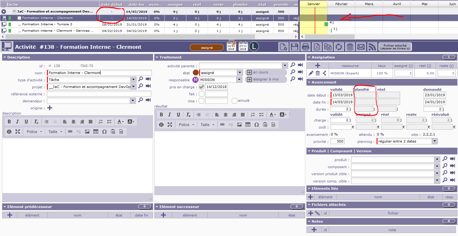

The load of a resource is not counted in the calculation and the different views (planning, global planning, reports, ...). Version 7.3.3.
See example in attachment.

18 Jan 2019 12:00 #3 by timshel
It's exactly what I did but same problem.
I also validate the planning.
I haven't got any scheduled date in the task. Validate date (start and end) are inserted.

21 Jan 2019 11:08 #5 by timshel
This is not an administrative project but an internal project.
