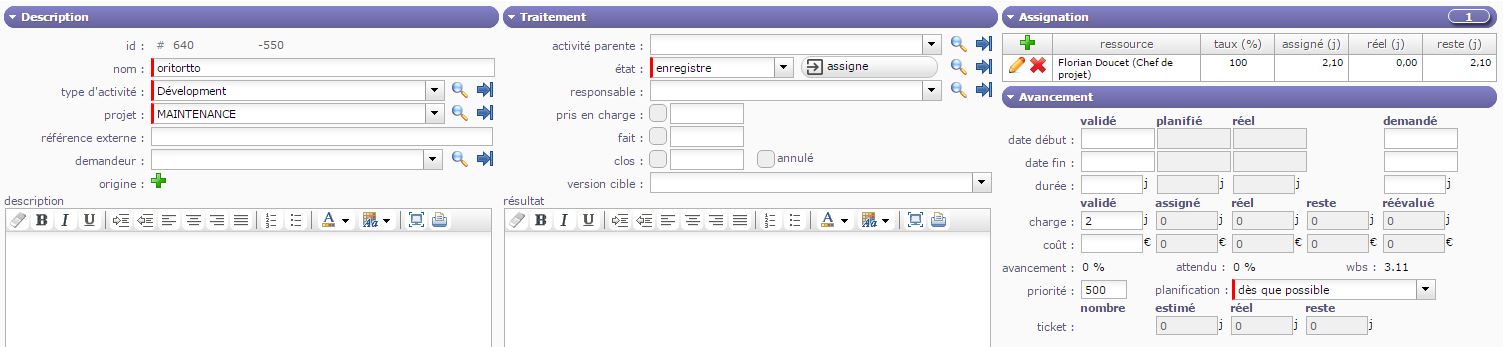

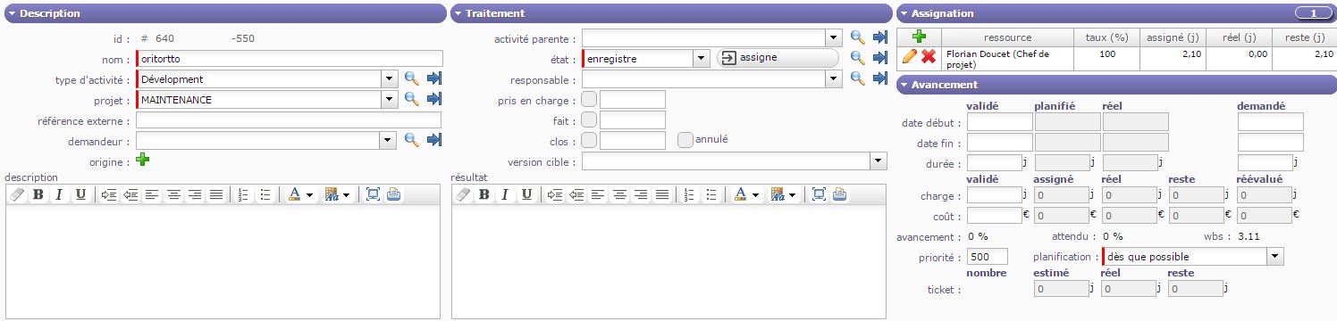

05 Oct 2015 09:54 #11 by fdoucet
Replied by fdoucet on topic ValidatedWork reset
i just test it in test, i have the same problem.
when i save with 2.1 in validatedWork
in first attachement the copy of database
in second the display after save
when i save with 2 in validatedWork
05 Oct 2015 10:27 #12 by babynus
Replied by babynus on topic ValidatedWork reset
Thanks for the print screen.
It's more clear with it.
So I can see that value is correctly stored in the DB, but not correctly retreived on screen.
Very strange...
I'll investigate about scpecificity of this field, but I'm afraid there is no specific display trick.
