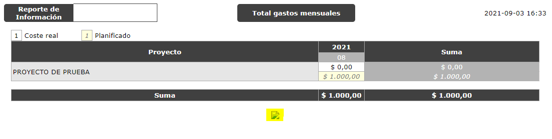

01 Sep 2021 14:22 #13 by babynus
Replied by babynus on topic REPORT ERRORS
Possibly you have SELINUX running that blocks access.
04 Sep 2021 00:16 #14 by MichelCA
Replied by MichelCA on topic REPORT ERRORS
Hi, good day.
Thanks for your comments and your help.
Effectively, if SELINUX was activated, we followed an tutorial that only disable selinux for projeqtor,  we disable all the selinux and the error stopped, Now we see only an icon:
Also we check the Log inside ProjeQtOr but nothing was shown.
Is there any other option or recommendation for this problem?
07 Sep 2021 12:07 #15 by babynus
Right click on icon as select "inspect".
Check url of image.
Then check that the corresponding image exists.
NB : the location of the image must be on the web root (check configuration for report files), otherwise images cannot be displayed

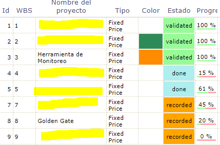

20 Nov 2021 00:52 - 20 Nov 2021 00:54 #18 by MichelCA
Thanks for your answer.
We did the projeqtor update and we also did the steps that you mentioned in the previous post for the database; the update and load of the database was done correctly, it did not show us any errors.
We use these commands to make the copy of the database:
     mysqldump -u root -p --all-databases > /home/opc/projeqtor.dump
     mysql -u root -p < /home/opc/projeqtor.dump
The problem we now have is that when we see the list of projects, some of the names are not there (As you can see in the image), the same happens with the name of some activities, with the resources, with the dedications.
Do you know why this happens? What has to be done to solve this problem?
