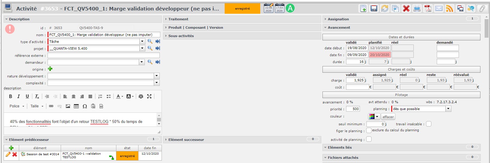

On a project that use predecessor chaining rule, we have many task that are planified to start before predecessor ending.
All task concerned are test session plannified on planningMode : as Soon as possible (9)
there is only one predecessor by task (testsession)

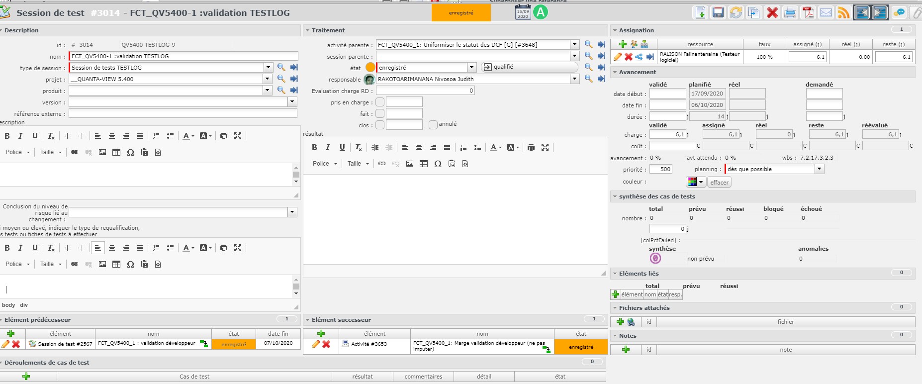

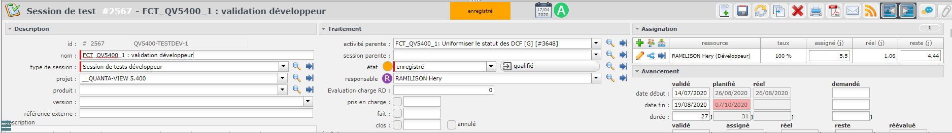

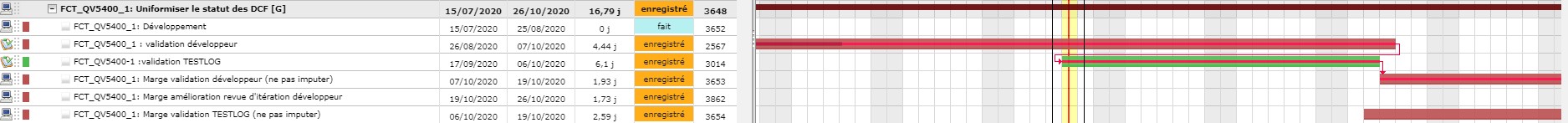

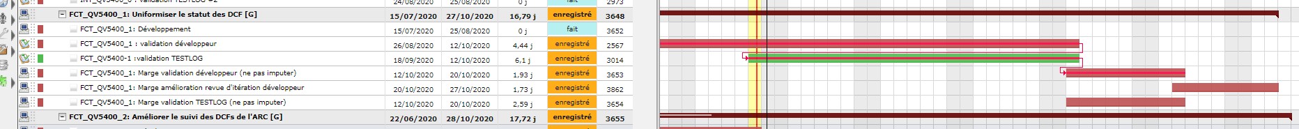

Planning of both task
Detail of predecessor test session (with end date on red)
Detail on successor test session with contraint date

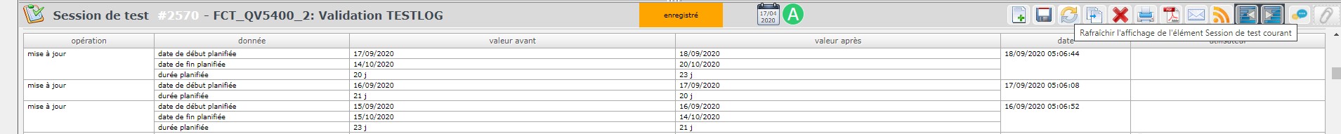

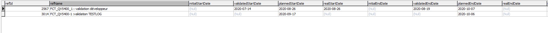

Database View of Planning Element
Do you have any ideas to explain this case, a solution so that this constraint is respected whatever the other constraints that apply

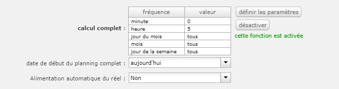

Of course, at least 20 time since problem was discovered
Planning is recalculated each day
Same behaviour

18 Sep 2020 15:27 #6 by alainforma
Is there some real work entered into the succesor ?
Is the sucessor is planified with a special mode as regular beetween to dates or planified intervention ?
