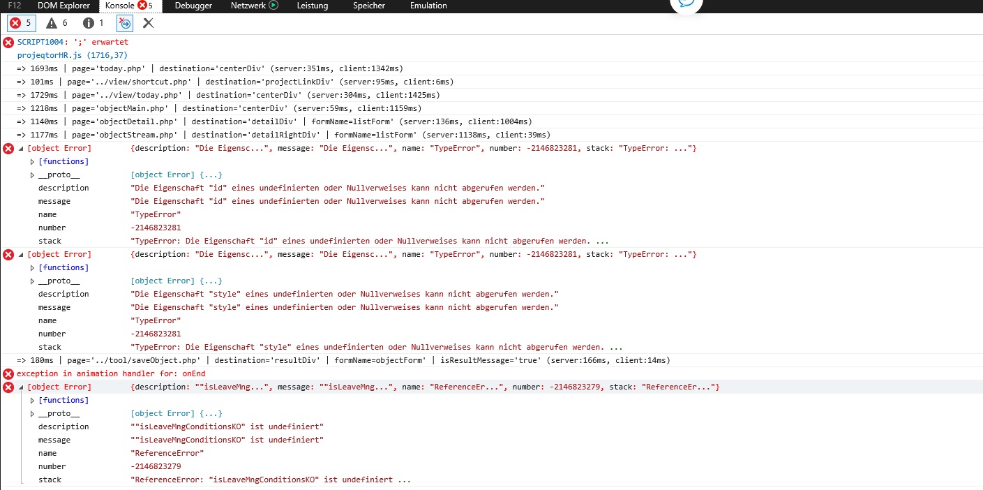

16 May 2019 14:19 #7 by 4ce
hi,
i deleted the browser cache via options - for now i did it again and also deleted the app_data - internet explorer cache folder.
but the same error appears.
attached you find the logs reduced to the errors since i logged in. at this point the loading dots/circle appears until i close the browser.
thank you for your help
16 May 2019 14:53 #8 by 4ce
short addition. i guess i made a mistake yesterday and uses the admin account on firefox. others than reportet has the administrator the same issue and after saving an item the loading circle-dots appears for an unlimited time.
it seems that he tries to update the mask. i tried to figure out what can cause the issue, i checked the error log and compare the code and it is no "easy" issue visible.
i try to log the firefox and look if has similar messages.
16 May 2019 15:48 #9 by 4ce
update 2:
error appears _only_ in internet explorer. Firefox, Opera, Vivaldi and Even Edge is working fine without any given error.
here is the last log, it seem it has a little more details
28 May 2019 11:24 #10 by 4ce
with 8.0.4 (installed in our dev-environment) problem seems to be solved.
