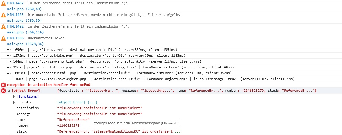

16 May 2019 08:17 #5 by 4ce
hi there,
at first, thanks for your quick replies.
for now, after deleting the cache, the firefox seems to work fine. internet explorer still have the same issues. on the attachment you can see the console-log.
i checked the behaviour with 3 different accounts on 3 different clients. with the same results: firefox works, iexplorer does'nt.
16 May 2019 11:49 #6 by babynus
It is a javascript issue.
Possibly also a cache issue.
Please be sure to completely clear the browser cache (F5 is enough for FF but not for IE).
If problem persists, please open browser console on login screen and post list of erros pointed out in browser console.
