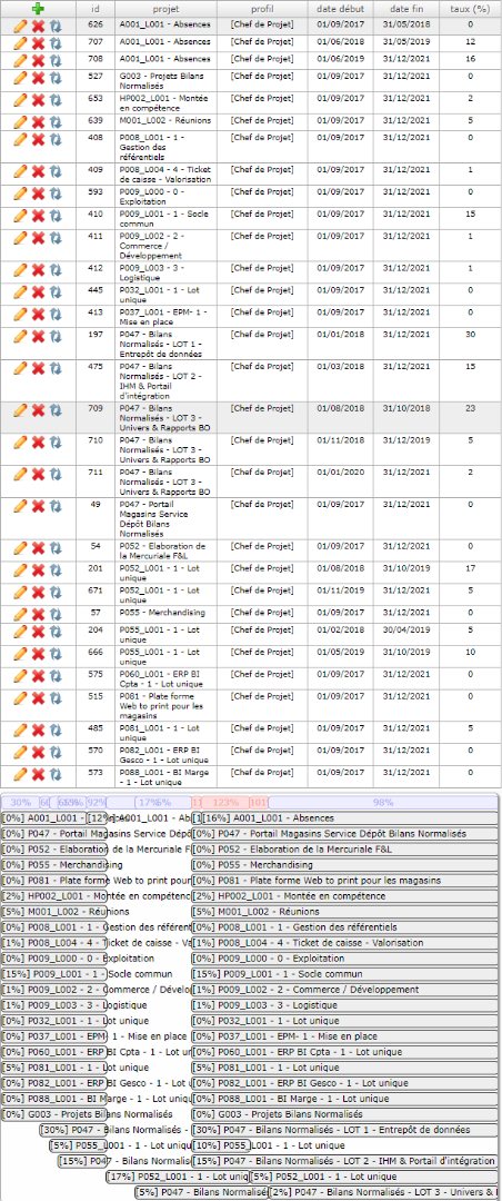

Hi
While trying to find a solution to my topic "9528-planning-calculation", I realize that I got a problem with resource affectation.
Have a look to affectation :
As you can see, there is a "hole" on the bottom of screenshot (between 01/08/2018 and 30/04/2019)
Almost all projects are cut in 2 parts (before 01/08/2018 and after 30/04/2019) except "P052_L001 - 1 - Lot unique" and "P047 - Bilans Normalisés - LOT 3 - Univers & Rapports BO"
I checked all start date and end date in each affectation, I see nothing wrong.
Can you explain me why I got this behaviour ?

Yes, the "hole" is stange.
Ticket #3664 recorded for analysis.
First remarks :
- these allocations are very complex, are they really needed to be so complex (several allocations to project...)
- you don't need to allocate resource to "Absence" if it is an "administrative" project
14 Nov 2018 21:41 #3 by apad
Replied by apad on topic Resource affectation
Hi
Happy to see that you consider the "hole" as strange behaviour.
Some answers to your question :
As you know, there are many steps during software lifecycle. For example, a project manager will work more during build steps and less during run step. In fact, if I could (If I had enough time to do it), allocations would be more complex because during build step a project manager will work more during specification and test steps and less during development step. That's why you can see several allocations to project. It's the way I found to be near reality.
If I don't allocate resource to "Absence", I won't be able to plan holidays (In France, you have to take rest to respect the law :cheer:). In a year, there are 365 days minus 104 days for week end minus 7 days for public holidays. It lets 254 days for working days. In my company, a resource can take until 42 days for vacation by year (25 days for holidays and 17 days for RTT). 42 days divided by 254 days is near 16% of working days ... If I don't "lock" this vacation time with allocation to "administrative project", I could believe that a resource is available more than 100% by year. Later, I will divide year with 2 periods : June to October (In France, Act imposes that a resource takes 20 days for holidays during this period else you have to give until 2 days more for the fractionning of vacation ... Dura Lex Sed Lex) and November to May for the remaining part. But I will wait that you solve my "hole" problem ;)
15 Nov 2018 23:51 #4 by babynus
Replied by babynus on topic Resource affectation
I would be interested in seeing your planning.
You should not need to define effort of resource for each period.
It is very hard to change when projets "slides" to later dates.
When planning is correctly defined with tasks for each period, and correct planning mode, repartition of work will be automatic.
