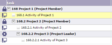

I've the following project structure (showing also the profile of the user for the project)
Project 1 (Project Member)
-Project 2 (Project Member)
--Project 3 (Project Leader)
In the 'Planning' form when he selects any project he gets the following message:
You don't have rights to access this Project.
Any subactivities that he selects are shown fine (even from projects he is not allocated to), although he is not able to create any new activities.
The 'Access to data (project dependant)' form show that a 'Project leader' is a 'Manager' for both 'Projects' and 'Activities'.
How can I find out why access is denied? And what should I change to make sure that this user has access to Project 3?

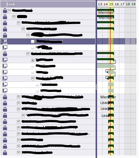

I'm not sure whether it's a related bug or by design, but even from projects to which he has no allocation at all, he can still see any activities even from sub-projects. I've also attached a screenshot of the structure.
