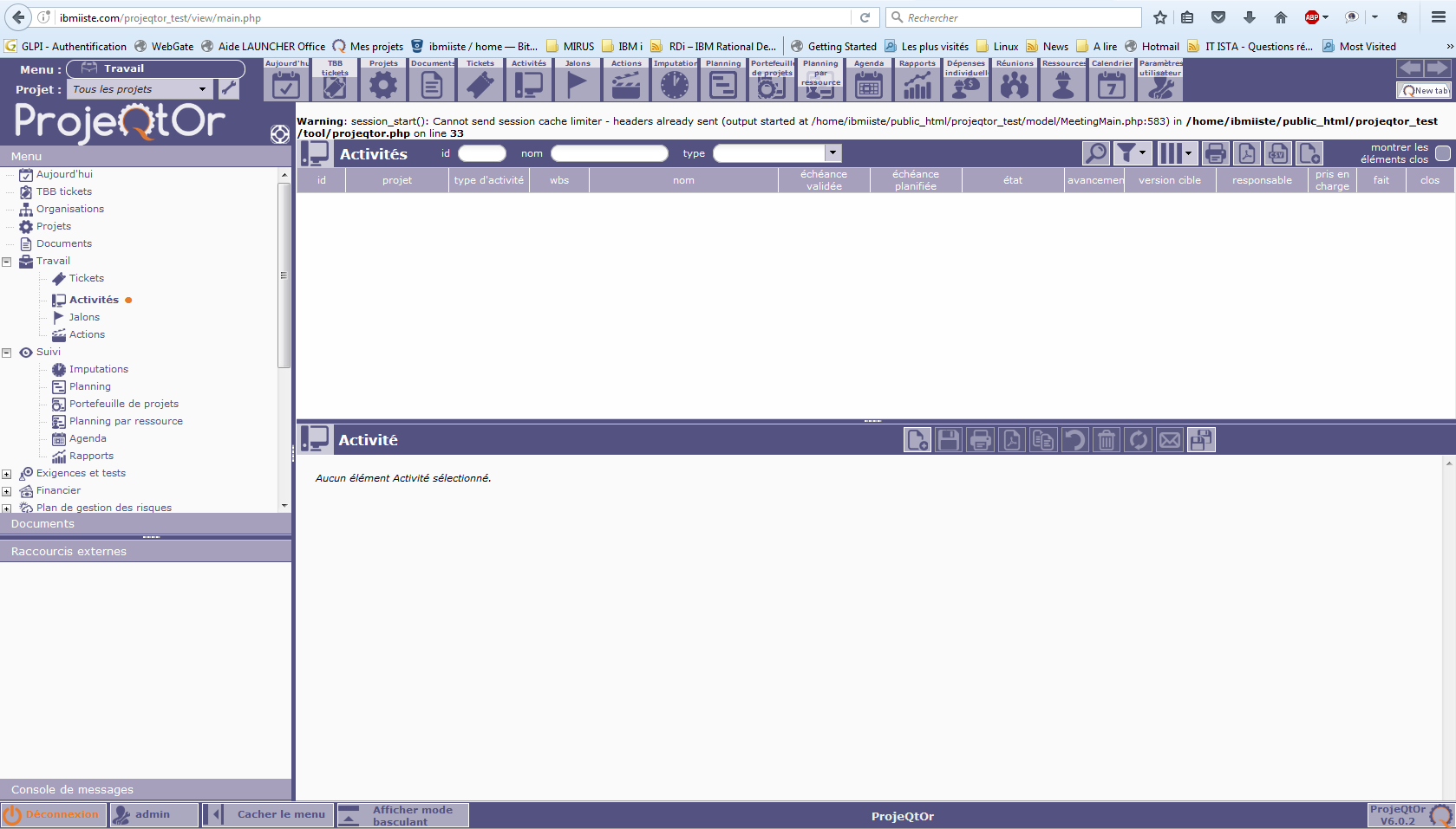

I am testing the 6.0.2 before using it.
When I udpate a meeting, I have a error:
Warning: session_start(): Cannot send session cache limiter - headers already sent (output started at /home/ibmiiste/public_html/projeqtor_test/model/MeetingMain.php:583) in /home/ibmiiste/public_html/projeqtor_test/tool/projeqtor.php on line 33
ERROR : Une erreur est survenue le 2016-12-02 à 17:14:45
And after that this error appears in all pages.

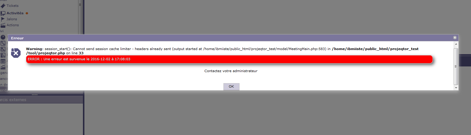

When I want to logout, a window appears with this error.

Cannot reproduce.
But it seems there are extra line at the end of file projeqtor/model/MeetingMain.php
Try and remove extra ending line (there should be nothing after the "?>"

Replied by Drubs2010 on topic Error on meeting 6.0.2
Thank you, there were some blank lines after "?>". I delete them and it's running again.
