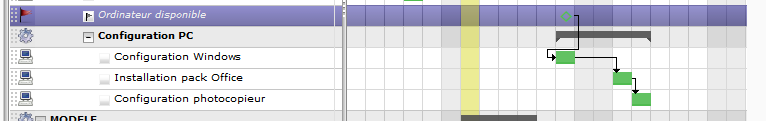

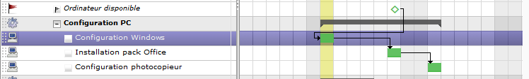

04 Sep 2016 13:07 #3 by FGAIL87
No precisely, is after calculating planning that the problem happens.
Here, the planning before assigning the work.
And there, the planning after assigning work and calculated planning.
Only the fixed milestone, has a valid date.
Activities have working duration in hours.

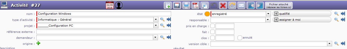

Can you please show detail of first task "Configuration Windows", with details of assignments.
04 Sep 2016 14:20 #5 by FGAIL87
The detail of first task

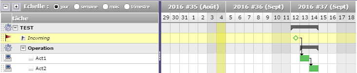

04 Sep 2016 15:51 #6 by babynus
Strange, all seems correct, and I can confirm that correct result is exactly what you expect ... and what I get.
What is the project type of your projects ? (Configuration PC and its parent)
Can you try and create dependency from milstone to sub-project "Configuration PC" ? What is the result ?
