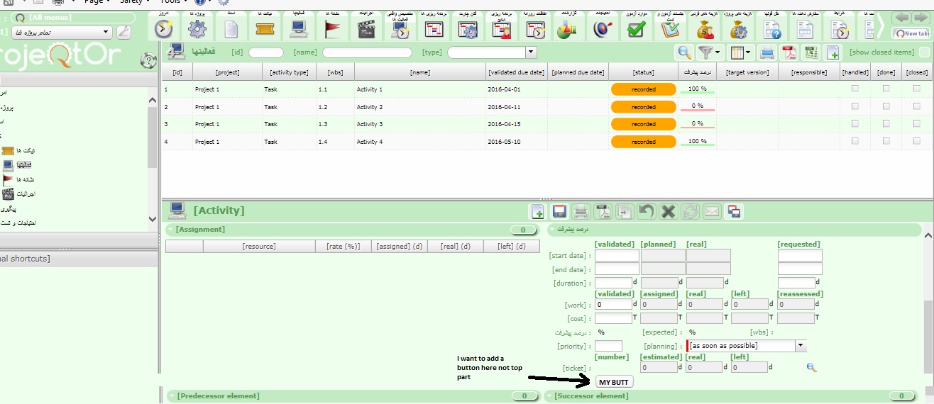

24 May 2016 21:07 #3 by keloniton
Thanks for your answer. I checked objectButtons.php. As i understood it is related to the buttons on top. I showed the place i want to place my button in the attached photo.
Thank you very much
24 May 2016 22:10 #4 by babynus
This king of button is designed in drawSpecificItem()
For instance have a look at this fnction in /model/WorkElement.php
25 May 2016 00:05 #5 by keloniton
Dear Mr babynus
Thank you for your reply Sir. My question refers to the place where this button is supposed to be located. I know how to make a button, but i do not know which file refers to the part i signed in the attached file.
thank you very much.
25 May 2016 08:19 #6 by babynus
It is really done in drawSpecificItem($item)
You need to have a field $_spe_yourItem in fields list, where you want to place it.
Then in drawSpecificItem($item), test if ($item='yourItem') and generate html objects you need.
Really, have a look at this fnction in /model/WorkElement.php, you should understand better.
