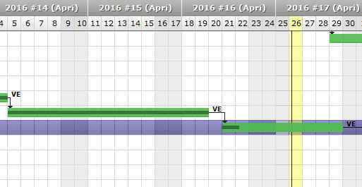

26 Apr 2016 09:14 #5 by igio80
Replied by igio80 on topic Absence
See attachments for green bar of Planning.
Resource in attachment file has not committed on 13 and 15 April (sickness) but Planning shows a filled green bar for those days. So I must see these days in Real Work Allocation.
Also I understand that in an Activity I must set only Validated Start Date and Assigned days for a Resource to view work percentage.
Thanks.
26 Apr 2016 14:30 #6 by babynus
Replied by babynus on topic Absence
Th e grey line does not represent days where real work is entered.
The greay line represents the progress of the activitiy, in %. The lenght of the progress bar fills the activity bar proportionnaly to the progress.
