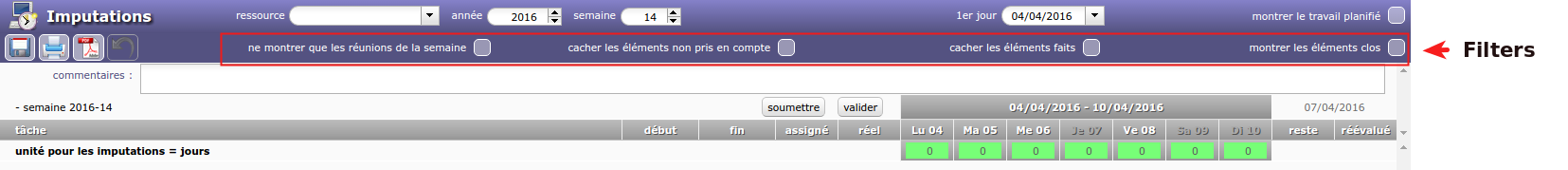

07 Apr 2016 16:52 #2 by richard.pare
Maybe is a side effect.
Assigned tasks with real work are always displayed, even if closed.
The goal is to show all lines of the sum for each column, to be able to check that the week is completely entered.
Do you have select a filter?
Either in screen "Real work allocation" or the global parameter "Display only handled tasks".
07 Apr 2016 17:02 #3 by derf
Hi !
There's no filter.
"Display only handled tasks" is set to "No".
Where is "Real work allocation" ?
Fred
07 Apr 2016 17:16 #4 by richard.pare
In french "Écran : Imputations"
07 Apr 2016 17:29 #5 by derf
ok.
this filter just allow to display closed tasks.
My issue is on done tasks (not closed).
The sum up on the project level is ok but there's a zero on detail lines ( which have been correctly entered before) ...
Fred

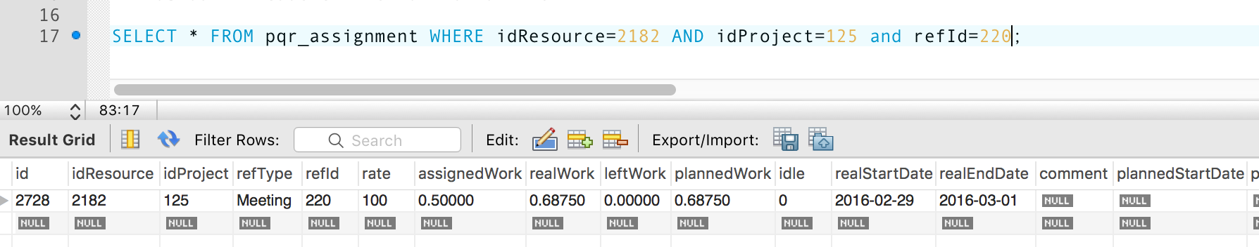

07 Apr 2016 17:54 #6 by derf
Plus étrange, lorsque je regarde dans la table assignment, je retrouve la bonne information
Stranger, detailed data is ok in mysql assignment table
