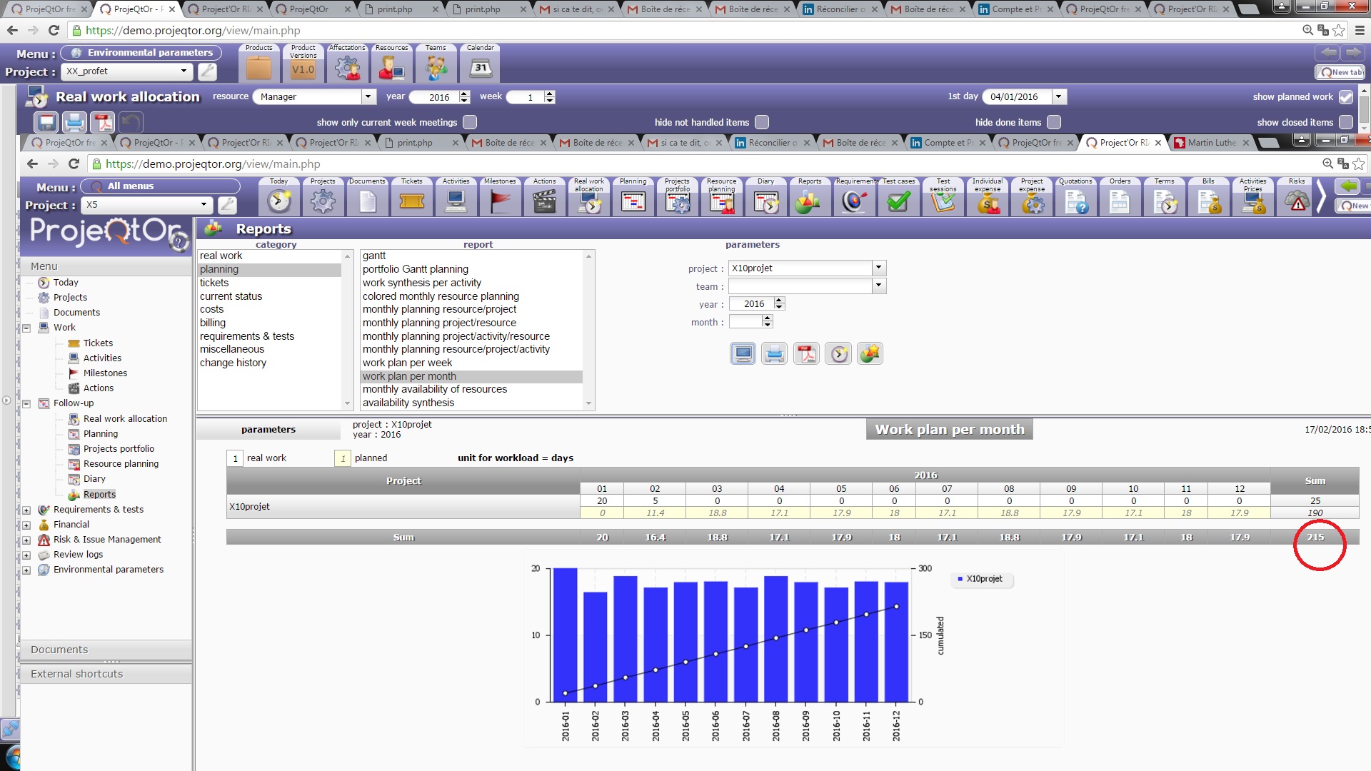

I have created a projet with only one resource on one year. The planned days = assigned days = reassessed days = 212. The resource a real work allocation of 25 days and no shift is identified on the planning. However in report “planning work plan by month” the sum of days is 215 instead of 212 (see attached copy display, surrounded in red) ?
Thank by advance for any explanation

17 Feb 2016 21:28 #2 by babynus
On february, you have real work and planned work.
I guess that real work was not entered exactly as planned (this is real life).
So you need to replan the project in order to actualize planned work on february.
Then report should be correct.

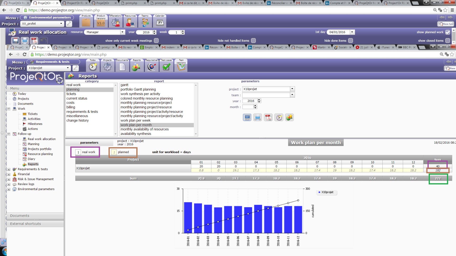

17 Feb 2016 22:14 #3 by chaussin
Thank you I understand the calculation. In fact you have to recalculate the activities planning in the planning menu to have the right figure.
But I have a comment regarding to the “work plan per month” menu, the data underlined in yellow should not be identified as “planned” data but rather as “reassessed” data as they are in conformance with reassessed data and not planned data once you recalculate the activities planning.
Eric
17 Feb 2016 23:13 #4 by babynus
In ProjeQtOr vocabulary, Reassessed means Real + Left.
The "yellow" work is the left work dispatched over days, what is called "planned".
18 Feb 2016 08:57 - 18 Feb 2016 08:58 #5 by chaussin
I have underline in same color (see display copy attached) the data that are consistent between project and planning. What is called “planned” in planning is in fact left days regard to the project data. That may be a little confusing as planned may be understood as initial charge in days.
