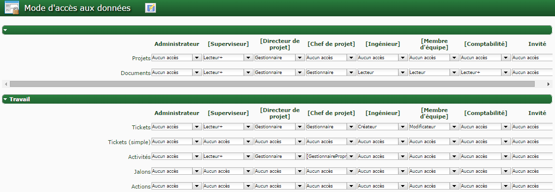

I have a problem concerning access modes. I created a new access mode named [GestionnairePropre] with this data :
  • Read rights : Elements of own projects
  • Create rights : Elements of own projects
  • Update rights : Own elements
  • Delete rights : Own elements
I am using this new mode to define the access mode for a specific profil to activities. The problem is that a user with this profil, when trying to add/modify an activity, can see even the projects not affected to him (Project field)
I was not facing this problem when i used the predefined access mode named [Gestionnaire] with this data :
  • Update rights : Elements of own projects
  • Delete rights : Elements of own projects
Have i done something wrong ? What de you think ?
Thank you :)

I reproduced : on creation, projects list is correct.
On update, project list is not limited.
It looks like a bug or at least a conception lack.
On update, if update acces right is "own elements", project list should be limited depending on creation acces right :
- if creation access right is "all project", list of projects should be all project (like existing)
- if creation access right is "own projects", list of projects should be limited to affected projects (to do).
Ticket #1529 recorded
