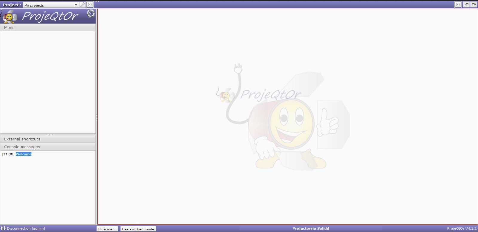

I've got a problem when I try to connect on my website using projeqtor/projectorria.
When I check the projectorria logs, I find multiple "Exception-[HY000] SQLSTATE[HY000]: General error: 2006 MySQL server has gone away" errors.
The result of those errors is that I DON'T see the icons on the top of projectorria website. That's like I could just connect to the website, but not using it properly.
Here is a link where I pasted my last logs: pastebin.com/aAUZ8Dvw :)
And I added a screenshot of the website I've got when I'm connected.

11 Mar 2014 12:45 #2 by babynus
It seems your mySql server is shut down.
Or possibly port has been closed.
