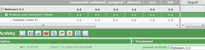

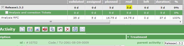

1) I am facing a problem with the calculation of real work on a few activities: the parent activity does not take into account all the real work of its children activities (see "Parent_real_work_problem.jpg").
I believe this has happened after moving around some activities / projects. In order to investigate where this might have come from, could you tell me where in the source code is the real work calculated for a parent activity ?

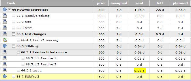

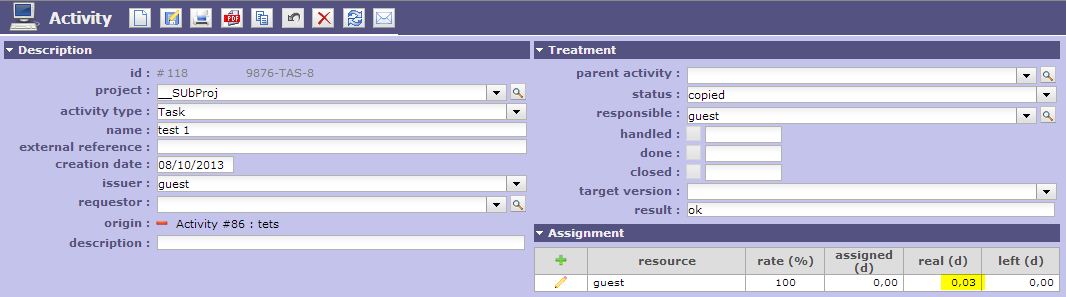

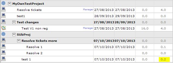

2) While trying to figure this out, I played in the "demo" Projectorria, and now see something strange: I logged some small amounts of time on a child activity (66.5.2 test1), and when I check the Planning or Activity details, the real work on this activity is different! (see screenshots Activity, Planning, RWA).
These tests are done on the "MyOwnTestProject" of the demo site.
-> Any idea what could cause this ?
Just becaus RWA (Real Work allocation) is in hours, others are in days.

babynus wrote: 1) I don't see "Parent_real_work_problem.jpg" attached :(
Sorry... here it is.
I am suspecting some corruption in the database maybe (probably not linked to the tool itself), but would like to understand how the code works to try to figure out what might have happened..
Extra note: we incidentally deleted the "Release notes P1" activity, and then the parent "Release 1.3.2" was recalculated to the correct value (see "Parent_real_work_OK").
2) Just becaus RWA (Real Work allocation) is in hours, others are in days.
Of course !!! :pinch:

10 Oct 2013 13:32 #4 by babynus
Calculation is done is the PlanningElement class (/model/PlanningElement.php).
On save, the update is automatically displatched to parent, recurcively.
So just updating value of the lowest activity will fix the data. It is what oyu did by deleting the activity ;)
