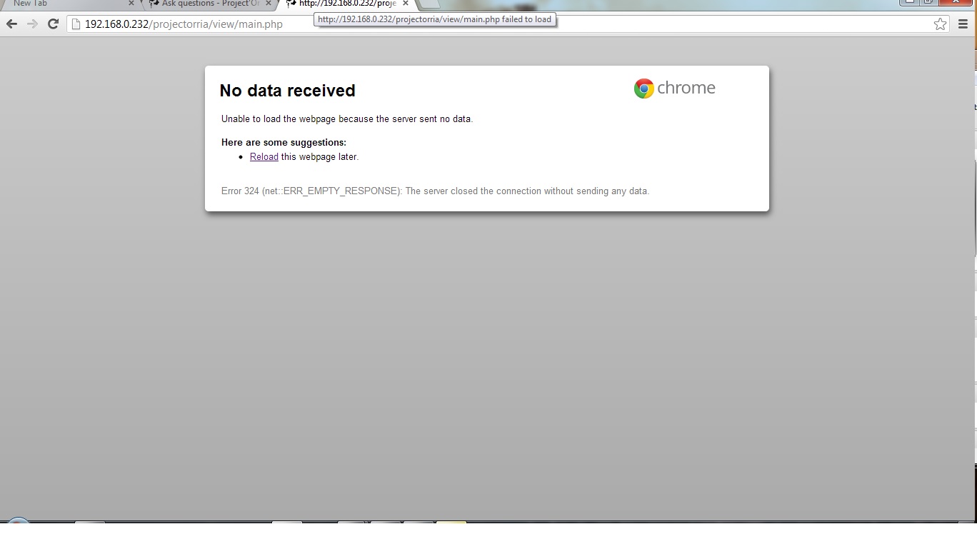

After i put all the necessary credentials, the "database created" message has shown
i click the continue then i redirected to blank page. please see the attach file.
when i check the database, the database is created but no table was created.

hi,
It seems you're facing a well known Chrome issue.
Here is what I found on forums :
It seems that error 324 happens for some who also run Internet Download Manager on their system. Here is the info I found:
If you get "Unable to load the webpage because the server sent no data" - open IDM and go to menu bar Downloads > Options > General and uncheck the "use advanced browser integration" checkbox.
So try another browser, and optionaly try the above workaround.
