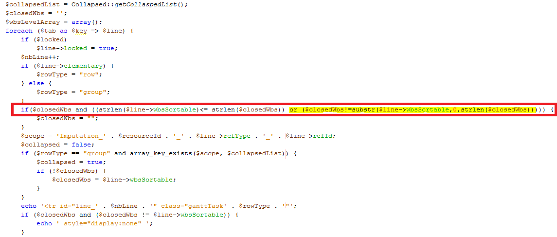

ImputationLine the file, in the drawLine function, for each row of the table containing the getLine function, there is a check and closedwbs wbsSortable of the current line. if two values ​​are different you hide the line, I will wish to understand why this administration and how it works.

The part of code your dealing with insures that when a level is "closed", all sublines are hidden. This is to be applied until wbs level is out of "closed" wbs.

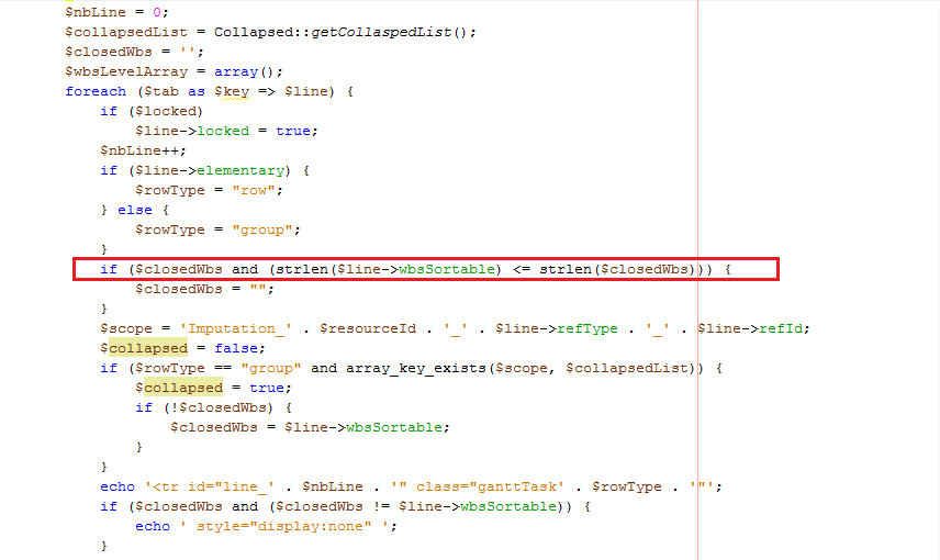

05 Jun 2013 11:26 - 05 Jun 2013 11:27 #4 by DjackJack
I continued my research on this problem and I think I have resolved.(Also in the imputationLine.php file in the drawLine function)
In my case, the user has rights on projects at different levels (eg Project A: wbsSortable = 002.004 and Project B: wbsSortable = 003.004.006)
When treatment begins, the project A and project follow through in the condition in attachment 1, all is well.
But arrived at the condition of project B attachment No. 1 does not work because I think the condition is incomplete.
This is why I allowed myself to change this condition by the condition in the attachment # 2
What do you think is correct? Is she a bad influence on another party? (I think not, but I ask because I do not quite mastered all of your code.)

09 Jun 2013 16:33 #5 by babynus
Your adaptation seem correct.
I'll test it, and possibly include it in next version.
