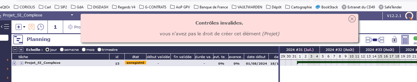

01 Sep 2025 12:08 #1 by Projeqtor_CD49
We have just installed version 12.2.1 on our test server.
In our PRODUCTION version (11.3.2), project managers could create their new project by making a copy of our template project.
With version 12.2.1, this is no longer possible (copy error message attached). We believe this is a legal issue.
Do you have any ideas ?
Thank you for your feedback.
Sincerely,
Christophe
01 Sep 2025 14:02 #2 by babynus
V12.2.1 just now ?
V12.2.2 is already deployed, you should hjave migrated to this last patch.
We had a security improvement on V12.1 toreinforce security.
This lead to issue when creating project at root of projects.
This was fixed on V12.2.2
My advise : migrate to V12.2.2 to get latest patch
and why not consider subscription service to get all fixes as soon as they are validated ?
NB :workaround for this issue
Project Managers can copy the template as new project "under an existing one that they manage", as a sub-project.
Then move the new project at root (it is possible for an existing project)

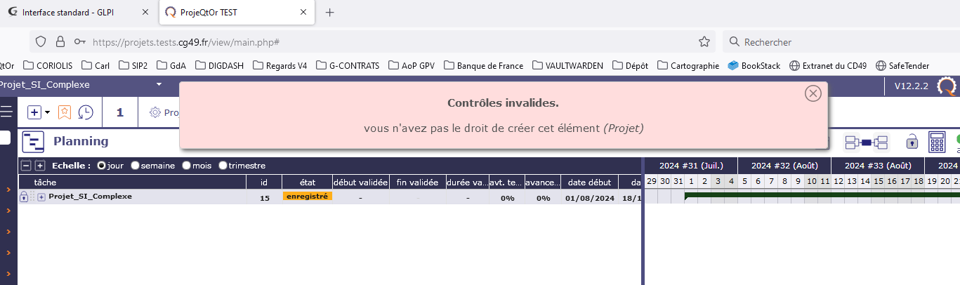

02 Sep 2025 14:03 #4 by Projeqtor_CD49
We just implemented version 12.2.2 on our test server.
I ran a new test copy of our model project and the error is the same (see attachment).
Sincerely,
Christophe

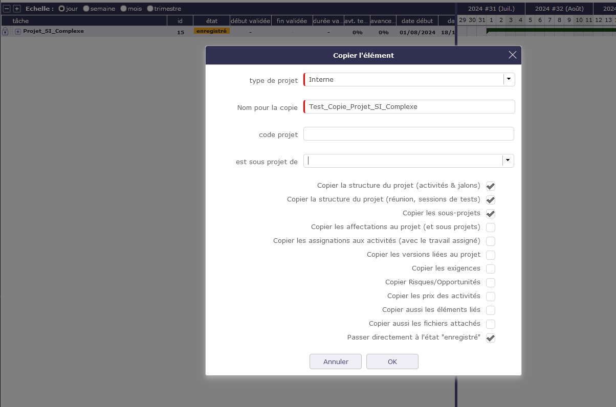

04 Sep 2025 12:29 #6 by Projeqtor_CD49
As I understand (correct if I'm wrong)
 - the Project to copy of type Template (Modèle) -> YES
 - user have defautl profile Project Leader (Chef de Projet) -> YES
 - you did not change defaut access rights -> the rights are identical
You'll find a screenshot of the procedure. This worked in 11.3.2 and is no longer the case with version 12.2.2
This is impactful for us because we cannot put this version into PRODUCTION.
