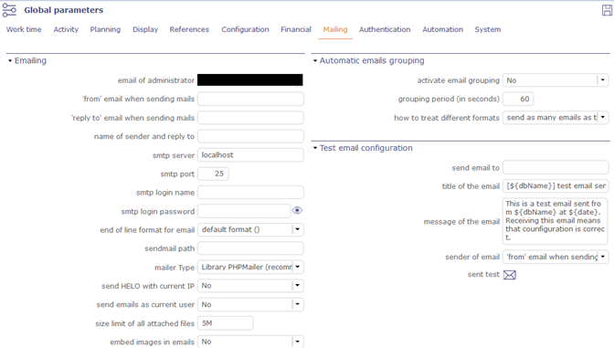

I installed Projeqtor using Softaculous on Web Hébergement Canada which is my hosting provider since I have no knowledge.  The install went well the only problem is that the Mailing parameters can't be saved.  Everytime I click on the save icon on the top right and I try to send an email by clicking on send text, there's a circle that turns forever and never stops.  If I change to another tab and go back to the Mailing parameters, I see that all the information I entered is gone and it only shows the information that are by default
You can see on the first image the mailing settings that keeps being shown even though I modify them and I click on the save icon.

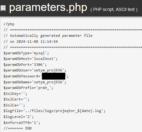

I did a search on this forum and saw someone else having the same problem and the solution was to remove information on the parameters.php file.  It didn't go into particulars so I don't really know which line to delete or modify.
On the second image, you can see the parameters.php on the web server.  My question is knowking what line I should delete,  Do I delete the line completely or do I change the value?  Which lines should I delete?  I'm not really knowledgeable in this topic so I would like to make sure I don't make any mistake.
Thank you in advance if you can guide me to the correct ways to modify the parameters.php so that the mailing settings can be saved once I modify it.
27 Nov 2024 09:55 #2 by babynus
Your parameters.php file seem correct and only contains expected parameters.
Do you have any error in projeqtor log file ?
