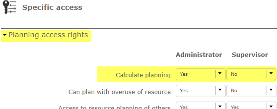

yes it is.
All you have to do is switch the planning calculation parameter to no in the specific accesses on the profiles that do not have access to it.

Thanks for your reply. I would like to allow planning calculation but not automatic planning calculation as the planning calculation start date and parameters can be set when not in automatic calculation. Is it possible to disable automatic planning calculation while enable manual planning calculation by admin for selected profile users? Thanks.
05 May 2023 08:50 #4 by Arkhanje
Replied by Arkhanje on topic Disable Automatic Run Plan
well no. It is not possible.
You can also just switch the button to deactivate this function and trust users not to reactivate it?!
