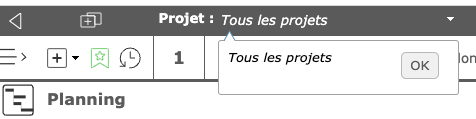

I have a report from multiple users. On my instance (10.3.2 freshly updated from 10.2.2 without issues), they cannot filter the projects with the WBS view.
They only have "All projects" available. (See empty.png)

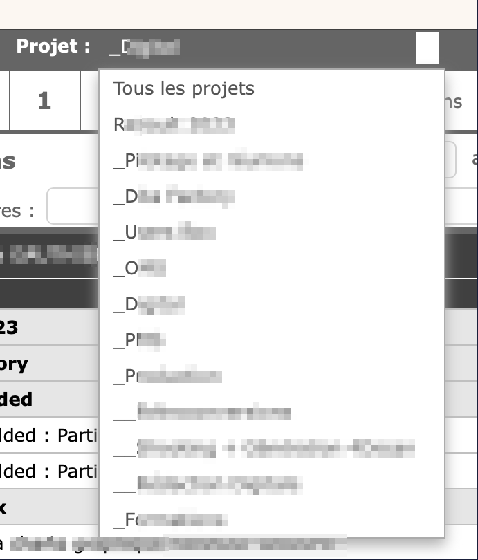

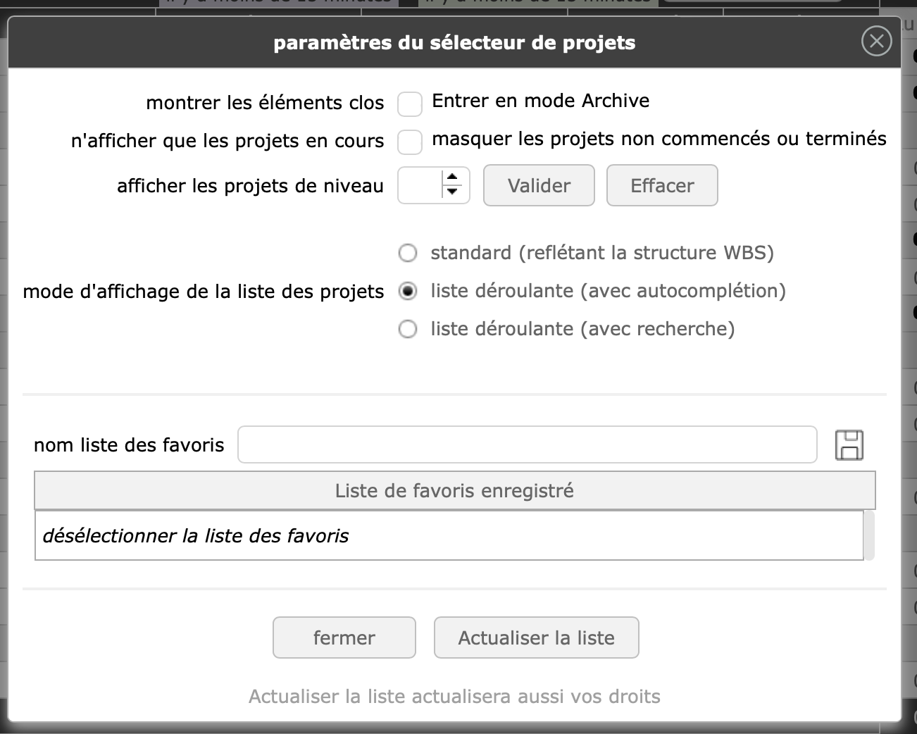

If they change the display mode for the the project list, they can see their assigned projects. (see valid.png & result.png)
On "valid.png", updating the list at the bottom has no effect / The browser cache has been deleted with no effect / multiple browsers have been tried.

This looks similar to what some of our users have been experiencing on v10.2.3, maybe ?
Is it possible to make a quick patch for v10.2 ?
Same symptoms : in "standard" mode some projects are not available in the list.
By using the "list" modes for the project selector, the full list is shown.
