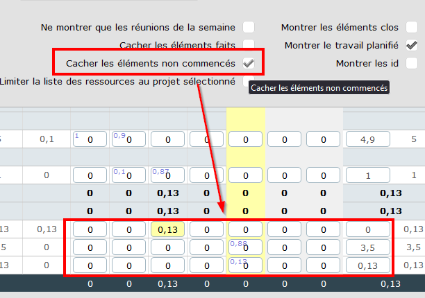

For the first time this morning he tried to declare his timesheet. Cells were available. He entered a 0.13 value for a meeting with a Ctrl+S just after.
just after the saving, all cells are now inaccessible. (see screenshot)

16 Dec 2022 10:45 #2 by matthieu.froment
Strange behaviour, if in the properties I check the box "cacher les éléments non commencés" then I can fill the time.
If unchecked, no possible action
See screenshot
My version 10.1.4

16 Dec 2022 14:08 #4 by matthieu.froment
I'm OK with your last message, but I do not understand why (for the same activity) :
- I can enter time when the filter is "on"
- I cannot enter time when the filter is "off"
The activity is in progress...

21 Dec 2022 11:08 #6 by matthieu.froment
I am sorry but I do not understand your answer. Just to summarize a bit my issue :
- I have a started activity in the workflow
- For the week, I have planified job to enter in the timesheet
It is in read only. If I click on the "hide not started activity", I can enter some time. But here, the filter has not effect because the activity is already started.
I have then a read only without filtering but read/write with a filter wich has nos effect (on hiding things) except allowing RW.
Normally, I should have the possibility to enter time without any filter.....
Really strange.
