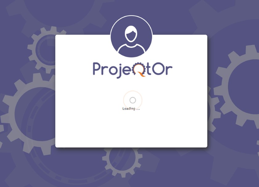

I would like your help to start Projeqtor.
After configuration and connection with "admin". the startup process is blocked as shown in the image below. I have left it running for more than 6 hours.
Thank you
Nourouddini

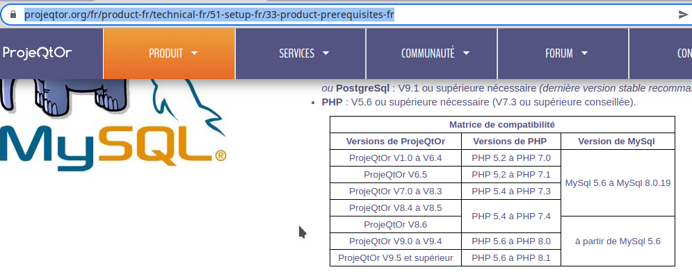

03 Jun 2022 20:42 #5 by gauvain
I disagree with you @Babynus: the page "technical prerequisites" clearly states that Projeqtor v9.5+ supports PHP8.1.
URL: <www.projeqtor.org/fr/product-fr/technica...uct-prerequisites-fr>
But indeed, I had the same problem when I deployed Projeqtor on PHP 8.1...
03 Jun 2022 20:45 #6 by gauvain
I add a screenshot of the prerequisites page.
