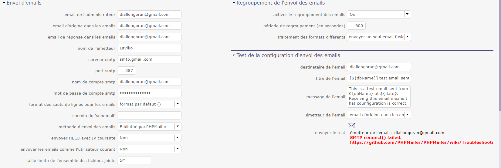

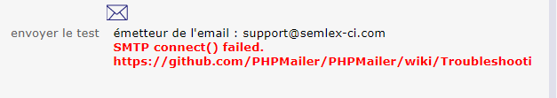

19 Apr 2022 13:50 #3 by ISDIA
I correctely configure the email sending. Before with O365 and after with gmail parameters.
See in attach my config with gmail parameters and the result of the sending test
19 Apr 2022 14:28 #4 by babynus
Sure configuration is wrong, as email cannot be send...
Remove option "sendHELO" (not needed for Gmail)
Also remove option "Send emails as current user" as most smtp servers won't allow to send emails with user deferent from accounts corrected.

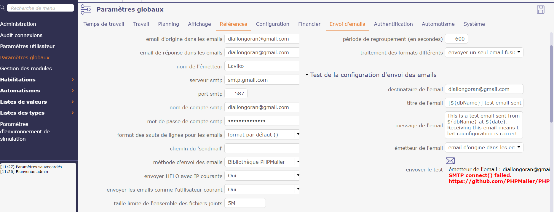

19 Apr 2022 17:34 #5 by ISDIA
HI,
It's unfortunately the same error
Nothing to do on the php config???
22 Apr 2022 15:56 #6 by babynus
Check projeqtor log file for possibly more description of error.
You should also request your email provider for logs on error to find out why connection to smtp server fails.
