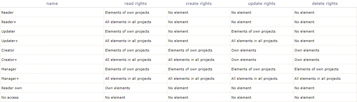

09 May 2022 09:17 #24 by Arkhanje
here is a capture of the access modes as they are by default in ProjeQtOr so that you can compare
