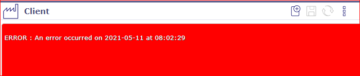

Hallo,
I'm new to Projeqtor. I'm on version 9.1.2.
When trying to create a new client I'm getting error, system is looking for additional files. I have asked my hosting company to investigate, according to them everything is in order on the server. Please see attached error and error log file.

11 May 2021 09:35 - 11 May 2021 09:36 #2 by babynus
Replied by babynus on topic Error
Please migrate to V9.1.3.
If issue persists, please post Projeqtor log file.

12 May 2021 06:19 #3 by du Plessis
Replied by du Plessis on topic Error
Hallo,
I'm hosting on cpanel it does not give me option to upgrade. How do I upgrade within the software?
Please see attached log file

12 May 2021 08:46 - 12 May 2021 08:47 #4 by babynus
To migrate you just have to overwrite existing code with new one and reconnect as admin.
Or you can buy our "auto-install" plugin that does it automatically.
The log you provided in Apache. We need projeqtor log file (you'll find it on Administration screen)

13 May 2021 08:16 #5 by du Plessis
Hallo,
Attached log file from the application.

14 May 2021 12:07 #6 by babynus
It seems you have issue with zlib compression.
Disable it on your php.ini
zlib.output_compression = Off
