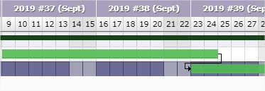

I created 2 tasks to make a test:
> Task A
> Task B with as successor of task A (End > Start + 5 days)
However in the planning view, the depedency does not apply (Please see attached)
04 Sep 2019 09:18 #2 by alainforma
It should be ! but...
Have you ever recorded some real work on B ?
Have you tryed to replan it ?
Regards.
04 Sep 2019 09:23 #3 by JulioLep
Thanks for your quick reply, no there is no work recorded as I'm initializing the plan, so without work recorded the depedencies are not takken into account ?
Yes I put auto calculation of the planning.
04 Sep 2019 09:49 - 04 Sep 2019 09:52 #4 by alainforma
The start date of the bar is displayed according to the 1st day with work recorded on timesheet. By adding a dependence (predecessor) with ( or without) a delay, the remaining days could be pushed back in time, the bar would grow longer (without any changes about the start date due to real work).
On planning screen view, even if the cell "automatic run plan" is checked, changes are not taken into account when data come from another screens. You have to enable the calculation. On the contrary, if you work directly on the planning view, every changes are taken into account when the cell is checked.
what is the version you are using ?
Regards.

04 Sep 2019 13:07 #5 by JulioLep
Ok I'll try and come back to you.
I'm using version 8.1.5
