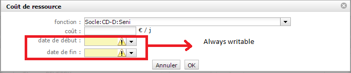

There is a strange issue in the way we use fonction. We can't fill the date field start and end.
The only way is to create the same fonction on the ressource, but how do you do if an "developper" become the "lead developper" ?
The two fonction can exist in the same time but project line will appear twice.
My reply proposition is in the picture.

20 Oct 2015 15:23 - 20 Oct 2015 15:42 #3 by gmontmirel
Replied by gmontmirel on topic Ressource fonction Date
We can't delete all of his assignment roles because he got input on his role for the related activity
This suggests another problem, we want to keep historic for billing.
I don't understand why those date are unavailable and the only way to fill it, is to increase the cost of function.
I think that the function could be end just for one ressource and one cost, without touching historic of the ressource.

21 Oct 2015 09:45 #4 by babynus
Replied by babynus on topic Ressource fonction Date
That's true : you can't delete a value used.
IT is because the dates are designed to increase the cost of function, not to define a validity period of the function.
This notion does not exist in function management.
