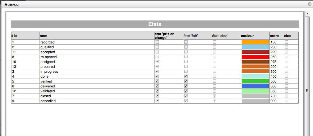

Two images to show my problem.
When I extract Status I have those two results : (with the same input layout)
With Print :
With PDF :
I don't really understand why the table does not takes all the page in the pdf extraction.. I would have if it was also in the print view.. but..

About PDF export :
I just tested on current version, export is correct in PDF.
I thing you changed some behavious in your version.
What is important to know about pdf Export, is that the library used (html2pdf) will not display correctly if you set width only on headers...
So you must specify the width of colomns on each line...
Moreover, for width in %, the total "must" be 100%. If less, it won't fulfill the page, if more, it won't fit in the page. This may be a real issue is your set columns selectable : you'll have to recalculate width to that total is 100% depending on selection :ohmy:
The following user(s) said Thank You: LEVA
15 Jul 2013 10:52 - 15 Jul 2013 11:48 #5 by LEVA
Annnh... And my happiness is gone..
I actually thought that the width parameter worked like print, and did not care too much about it ^^
So yes, when I create the export Layout, it has its own witdhs..
OK, I think I have a solution... :)
And problem solved :)
