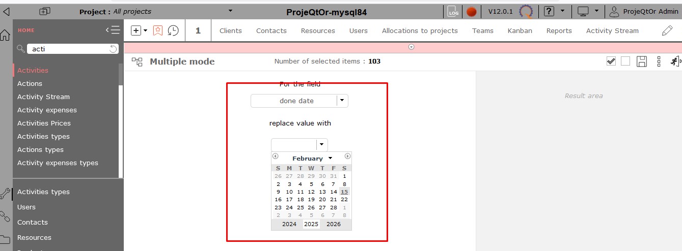

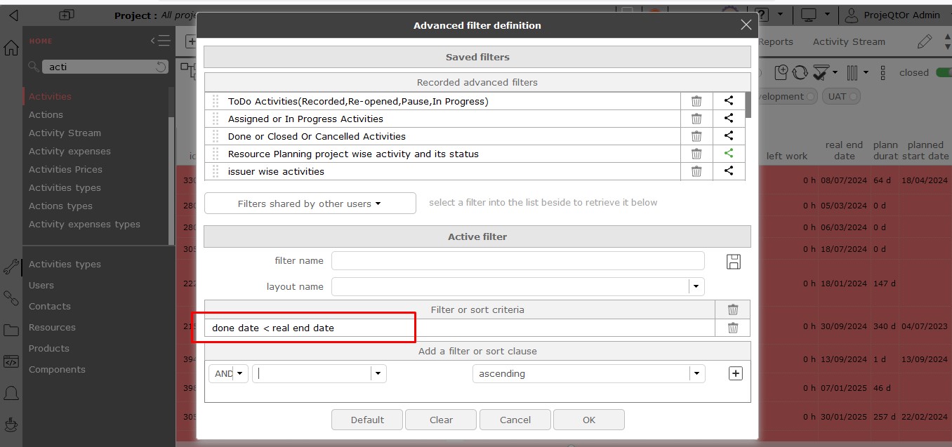

15 Feb 2025 12:43 #1 by chandrashekhar
Hi ProjeQtOr Team,First, I wanted to say how much I appreciate the new "Compare Values" feature in version 12.0.1! It's already proven incredibly useful. I was able to use it to successfully identify activities where the "done date" is earlier than the "real end date," which is exactly the information I needed.I'm now exploring how to best act on this filtered data, and I've run into a slight limitation. I'd ideally like to update the "done date" in these filtered records to automatically match the "real end date."While the "Update" functionality allows me to select the "done date" field for modification, I don't see an option to specify that I want to populate it with the value from the "real end date" field.I've attached some screenshots for reference, which hopefully illustrate the use case more clearly.Could you please consider adding a feature that enables field-to-field updates based on the "Compare Values" filter? This would greatly enhance the utility of this feature, allowing us to quickly and efficiently synchronize data across records.Thank you for your consideration, and for your continued work on ProjeQtOr!Best regards,
