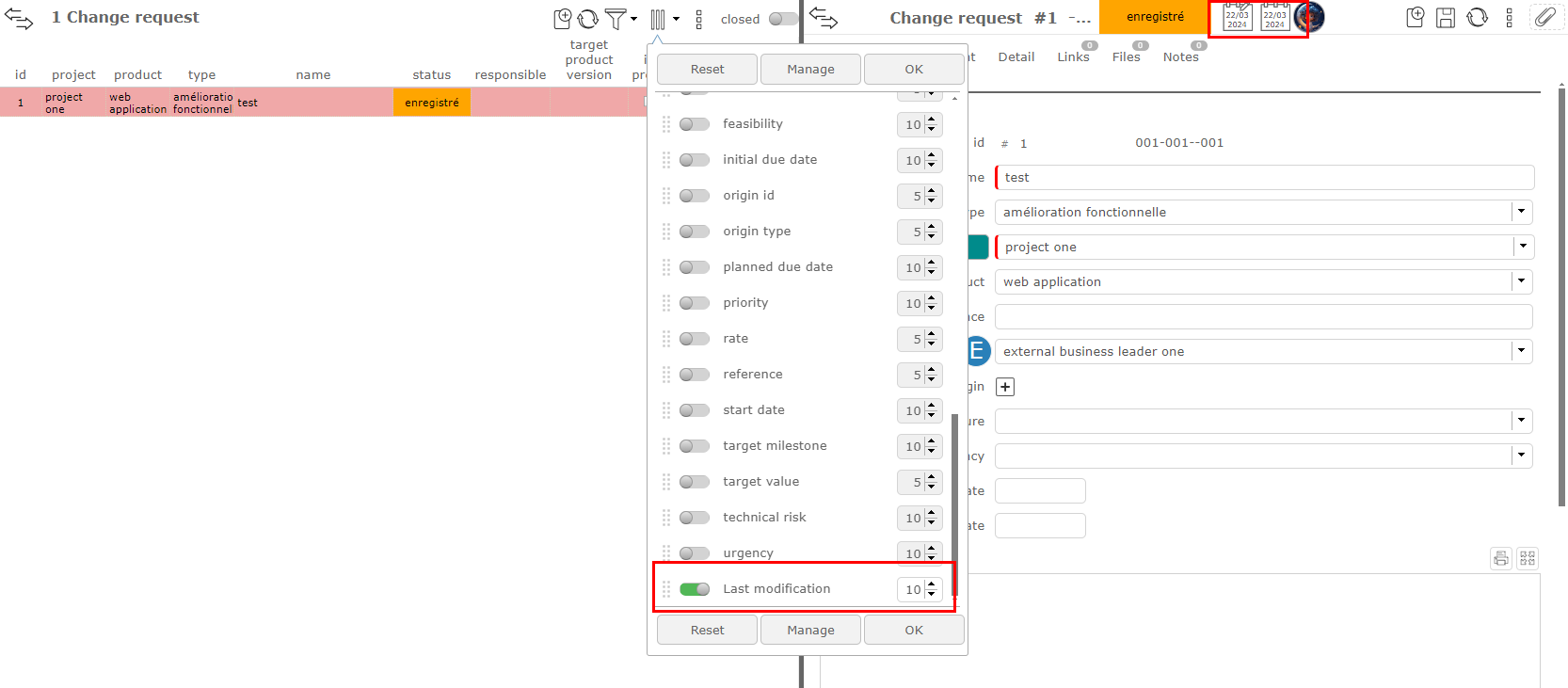

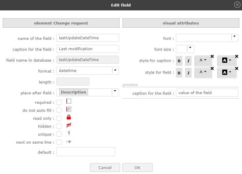

Otherwise a workaround would be, with the customization plugin, to create a field with the latest update:
lastUpdateDateTime (date and time)
lastUpdateDate (date only)
once the field has been created you will see the creation AND modification informations in the header of the detail area and you will see in the columns the newly created field which will allow you to sort your lists
25 Mar 2024 10:31 #3 by OliverOde
thank you very much for the suggestion, it works wonderfully.
Greetings
Oliver
