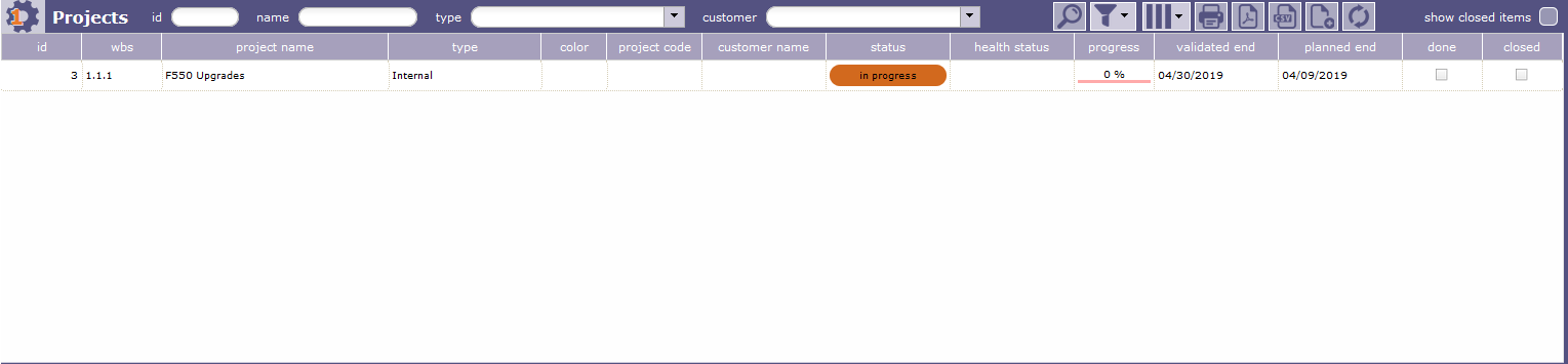

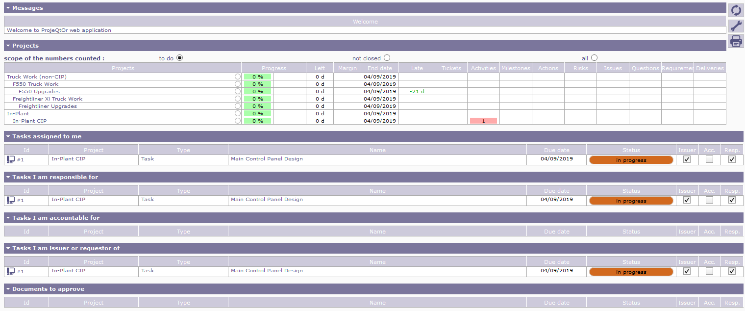

Most of my projects are missing from the projects screen. All of them do show up in the "today" screen, and if I click one there, it then shows up in the projects screen,, at least for a while. The Projects table in MySQL looks ok, I'm not sure if this is database corruption that I'm just not seeing, or something else. Is there a way to pull logs that would be helpful, or does someone have any other advice in troubleshooting this? This happened after my computer shut down improperly (the servers are on this machine as well.) The activity I've created doesn't show up in activities either.
