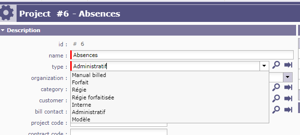

01 Mar 2019 14:00 - 01 Mar 2019 14:08 #4 by alainforma
Hi
Administrative project are not operational project type. There is no work left to inform on them.
To solve your problem, simply change the type of this project administrative to another type and then you can close it.
Just change the type as shown below.
Regards.

22 Jul 2019 13:21 #6 by ahmed.linkoln
What if I can't project type? I try to change from administrative to other. See sreen loading for some time, but nothing is changed. "Save" button is highlighted again.
