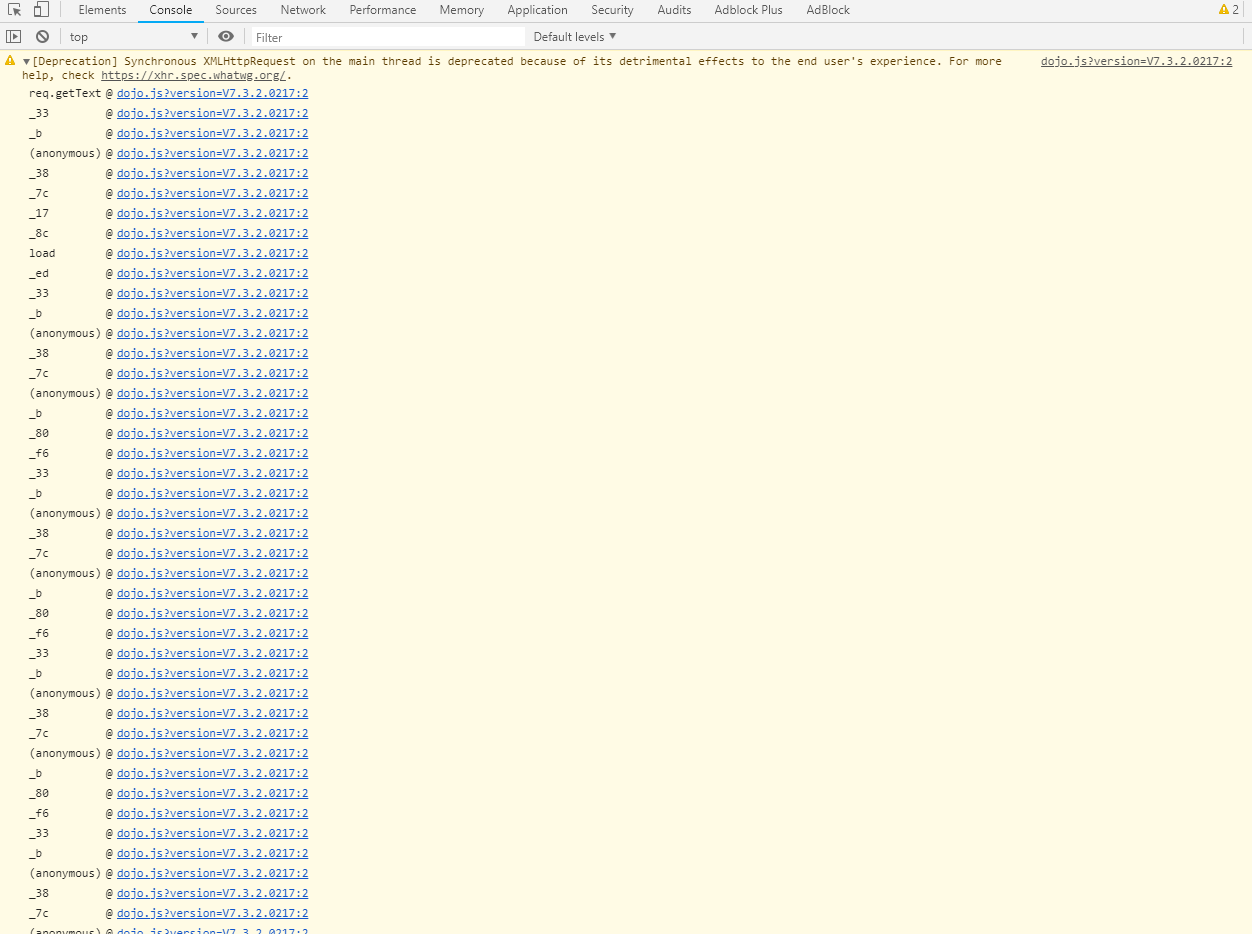

On dev tool, you showed network tab.
We need content of log console.
07 Jan 2019 14:32 #8 by desperados
Here is the log console :

07 Jan 2019 22:00 #9 by babynus
No error.
Difficult to find source without a hint.

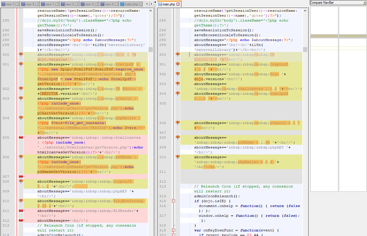

11 Jan 2019 12:14 #10 by desperados
Hi Babynus,
Sorry for the time response.
Here are the results of the step-by-step upgrade :
V7.2.5 ==> V7.2.6 Ok
V7.2.6 ==> V7.2.7 Ok
V7.2.7 ==> V7.3.0 KO, empty page
I have uploaded the log file, but there is no error...
As my screenshots showed, the main.php loading is breaking at line 301. It seems there is an issue in retrieving the Html2Pdf version.
Here is the source code from the main.php file :
      aboutMessage+='&nbsp;&nbsp;.&nbsp;Dojo : '+dojo.version+'<br/>';
      aboutMessage+='&nbsp;&nbsp;.&nbsp;html2pdf : <?php use Spipu\Html2Pdf\Html2Pdf;require_once '../external/html2pdf/vendor/autoload.php';$html2pdf = new Html2Pdf();echo $html2pdf->getVersion();?>'+'<br/>';
      aboutMessage+='&nbsp;&nbsp;.&nbsp;CK Editor : '+CKEDITOR.version+'<br/>';
And here is the source code issued from the web server :
Does this give you some leads?

11 Jan 2019 12:24 #11 by desperados
Also, when I compare the V7.3.0 main.php file with the V7.2.7 main.php file, that's exactly here where there was a modification by the update.
Jordan LE NUFF
IT Project Manager
11 Jan 2019 12:30 - 11 Jan 2019 12:30 #12 by desperados
After a few tests, the error seems to be in the "$html2pdf = new Html2Pdf();"
I'm still investigating.
