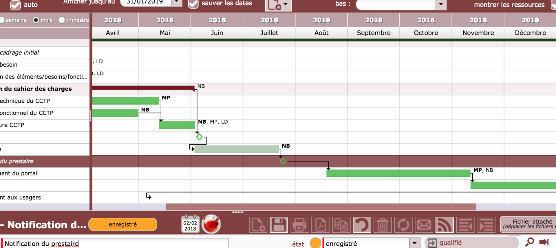

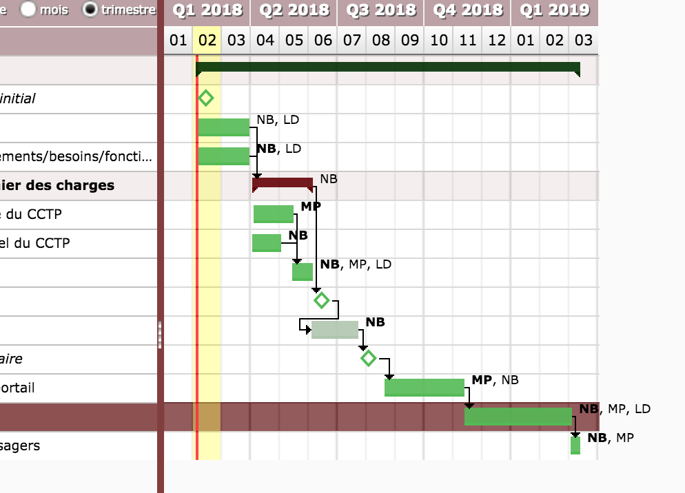

j'ai l'impression d'avoir un bug d'affichage concernant la vue mensuelle, semaine et jour du gantt (trimestre est OK) sur la version 6.5.2, constaté sur Firefox et Chrome MacosX.
Voir les snapshot (mensuel ->KO, trimestre ->OK).
Merci de votre aide.
LD.

I guess I should have write my issue report in english. I have a problem with gantt view for weeks and monthes (trimestre is OK) on projeqtor version 6.5.2. The issue has been experienced on last version of Macosx Firefox and Chrome browser.
see snapshot (mensuel -> KO, trimestre -> OK).
Thanks for your help.

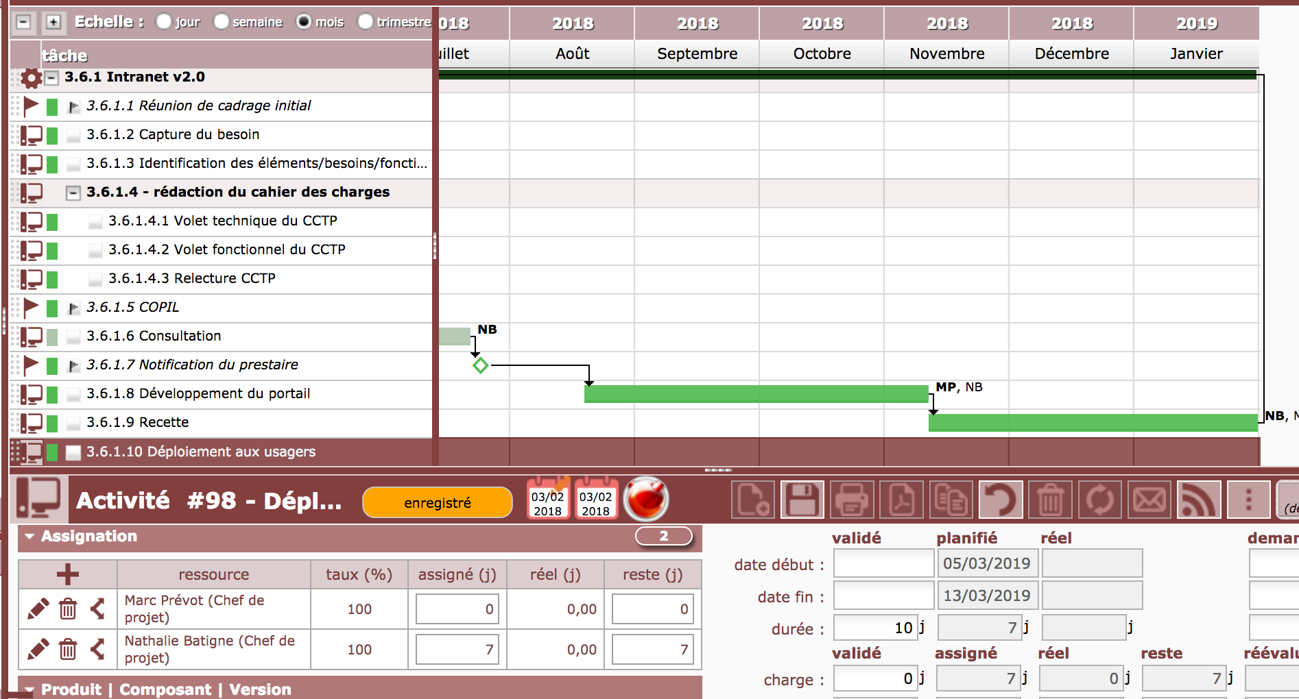

03 Feb 2018 20:30 #4 by babynus
Replied by babynus on topic Pbm d'affichage Gantt
Hi
Very strange.
I never faced this kind of issue.
It seems that arrow is wrong... as latest task should appear after previous one.
Could you please :
- send screenshot of last activity, with the progress part( all dates)
- try and reproduce on other OS (windows or else)
- try and change start date of display so that last task appears, and post screenshot of result
03 Feb 2018 20:51 #5 by dairaine
Replied by dairaine on topic Pbm d'affichage Gantt
Thanks for your help;
* I have tried the same view on Windows 10/Firefox -> same problem
* Actually, the last task does not appear at all in the gantt because Its date is 03/2019 but the gantt display date was up to Jan 2019.
* When I setup the gantt display (end) date to march 2019, the display becomes OK. So my display problem is resolved when I setup properly the display dates. Not sure it is a "normal" behavior.
Thanks.
LD
04 Feb 2018 01:44 #6 by babynus
Nor, it's not a "normal" behaviour.
We should not see the dependency line with end date before start of last task.
It seems to happen for last task when end date is defined (in most cases, it is left blank, so this issue does not appear).
We'll have a look.
Ticket #3233 recorded
