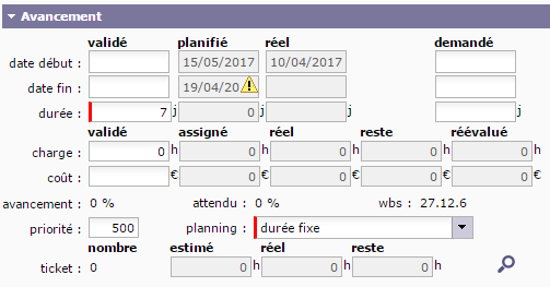

I have a big problem with planification and planned date : I have 41 elements (activity and milestones) with planned end date before planned start date. I tried to modify it on database, and run automatic plannification, but the issue occurs again.
With this problem, I can't change anything on the element form.

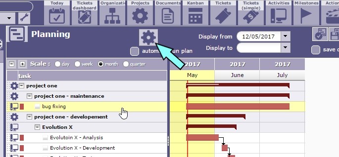

I have try the same case , i have the error when i don't calculate the planning manualy .
Try to calculate planning with the button calculate planning ( see attachment ) .
