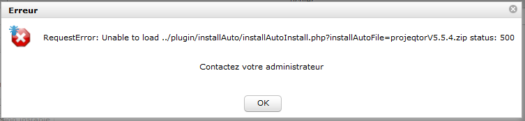

21 Oct 2016 17:36 #1 by ndusch
There is another issue with the Plug-in Autoinstall.
When the update from V5.5.3 to V5.5.4 will be started there is following message which appears.(see attachement)
Did you met this issue before?
ND
21 Oct 2016 17:44 #2 by babynus
Replied by babynus on topic Plug-in Autoinstall error
Can you show browser console and projeqtor log file.
Most likely is that your network configuration forbids to connect from your server to projeqtor server. Check this with your netword admin. Maybe he has to allow access to projeqtor.org domain.
21 Oct 2016 17:50 #3 by ndusch
Replied by ndusch on topic Plug-in Autoinstall error
attached the log file.
The zipFile of Projeqtor Installation is downloaded locally on server. We can see it in the autoinstall folder.
ND
21 Oct 2016 17:54 #4 by babynus
So this is possibly an acces right issue.
To migrate application, the plugin will overwrite the whole code, so you need to give write rights on all the folders and files of projector to php user (www-data)
There is no error in the log file.
Possibly error is in apache error log.
Could you please post it here ?
24 Oct 2016 14:26 #5 by ndusch
I had this error in the Apache logfile :
PHP Fatal error: Maximum execution time of 30 seconds exceeded in C:\\WebServer\\Apache24\\htdocs\\projeqtor\\plugin\\installAuto\\installAutoInstall.php on line 80, referer: http://192.168.1.9/projeqtor/view/main.php
So, I changed the max_execution_time to 100 in the php.ini file and now, it's OK, I can upgrade my projeqtor!
Thanks for your help.
