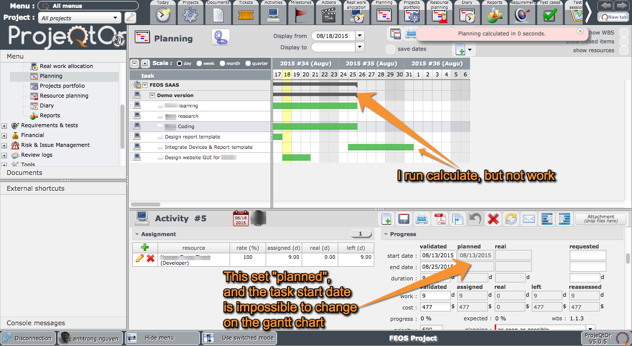

Hi Babynus,
Maybe I'm wrong at some step that lead to the bellow issue that I think it can be a bugs:
1. I create several activities: task
2. I create another activities: phase.
3. I use gantt chart to indent all to this phase --> The phase time is now start from the min start date & end by max end date of these task
4. Then I map some activities (tasks) as successor.
--> Then here there are a problem:
a. The phase time line is not cover all the the time of the task, it shorten to a random date (I think)
b. The task that is a successor in step 4 is set planned & disable even I remove the successor link. So I cannot change it back to previous validated date.
==> Could you help check if it's a bug or I just make a mistakes some where else?

18 Aug 2015 10:49 - 18 Aug 2015 10:51 #3 by jotrong
Replied by jotrong on topic Bug on Gantt chart
Hi Babynus
Thank you for your quick answer.
But for a. point, I make calculation already, but it still the same
For b, I attached the image to be easy to understand --> I cannot change start date on the gantt chart.
Many thanks for your big projects that is really worth for us.
Jotrong

18 Aug 2015 11:07 #4 by babynus
Replied by babynus on topic Bug on Gantt chart
Could you first check for errors in log file.
What is weird for me is the caclulation message : "planning calculated in 0 seconds" (it's faster than light)
and message is in ping background.

18 Aug 2015 17:46 #6 by babynus
I think the issue comes from planning calculation.
It is not normal to have zero calculation time : even with only 1 project, with no activity, I could never go below 0,02 second for planning calculation...
Please try and clean log file, run planning calcuation and post log file here (whatever it contains)
Also check for errors in browser console and in apache log file.
