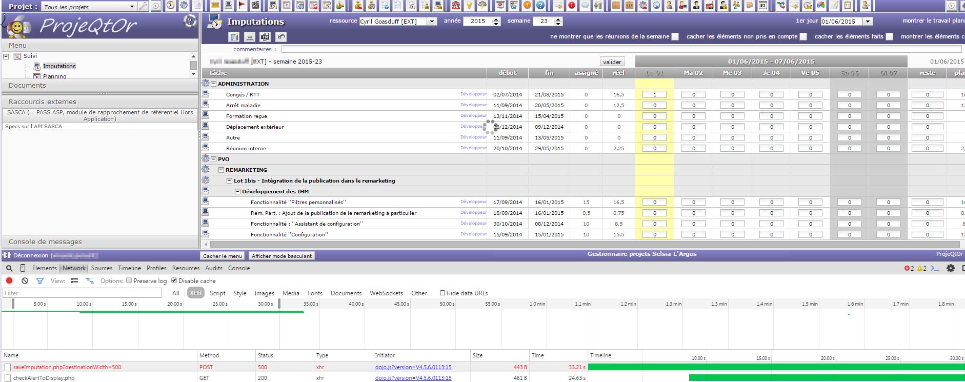

01 Jun 2015 18:23 #7 by vporcelli
Console screenshot attached.
Thanks.
01 Jun 2015 18:26 #8 by babynus
Error 500 : it means you have some serious PHP error.
You should find error in the PHP or Apache Log file.
