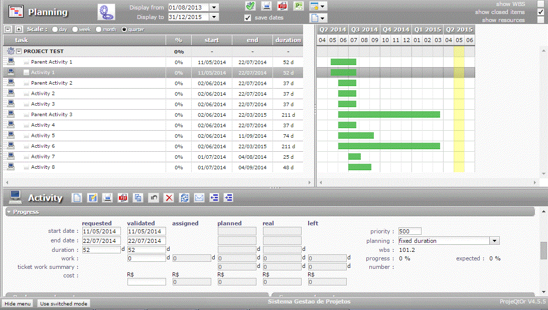

I'm importing to projeqtor several activities from XLS files using the "import data" functionality. I have no problem with the import process itself, but I realised that the dates that are being recorded in projector are diferent from the ones in the XLS file by " -01 day ". Example: if in the XLS file the activity START and END dates are "2015/01/20" and "2015/01/30", when imported to projeqtor these dates will be "2015/01/19" and "2015/01/29" (date format yyyy/mm/dd).
Please see the attached XLS file with an example of activities which were imported and the result after importing them in projeqtor in "Planning screen". Pay attention to the start and end date, comparing XLS file dates X projeqtor dates.

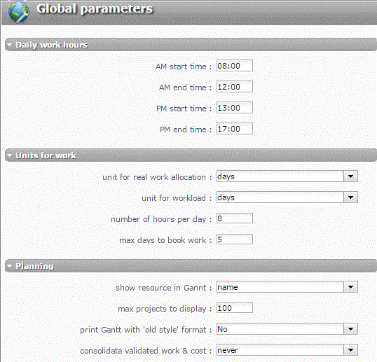

I'm not sure the reason of it. Just to make sure, I've attached my global configurations related to days and work allocation, to make sure it is not wrong.

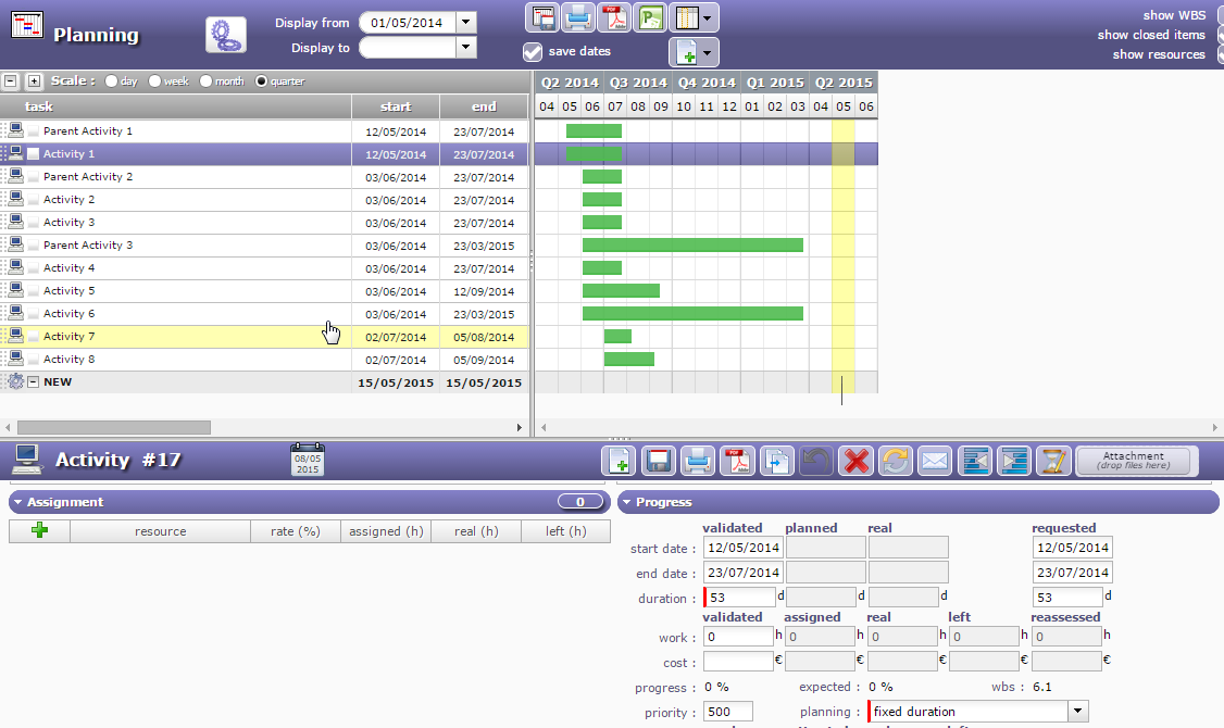

I cannot reproduce the issue.
When importing your file, dates are imported exactly as in the file.
(see attached screenshot)
