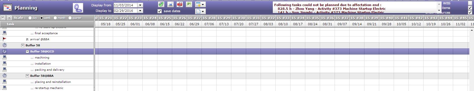

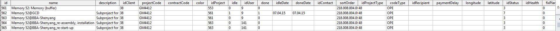

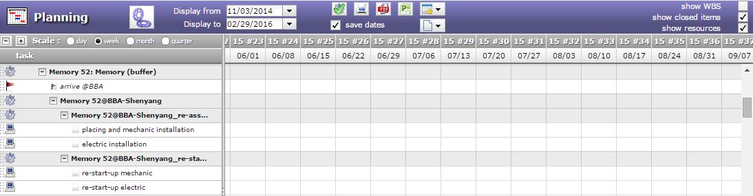

09 Apr 2015 11:18 - 09 Apr 2015 11:25 #6 by gordianus71
Dear,
currently I am running version 4.5.7 (about info shows 4.5.6) while issue #1650 has been reported closed within version 4.5.5. Unfortunately I cannot see closed projects in the planning mode with check box "show closed items checked". I can still see these projects in the database, while they are not visible in the application.
Attached you can find a screenshot from the table "project" and the respective screenshot from Projeqtor in the planning view.
Strange enough there are closed activities shown when the subproject for these activities was not closed, see attachment 3.
If you need more data to be able to look into, please let me know.
Have a great remaining week
Christian
